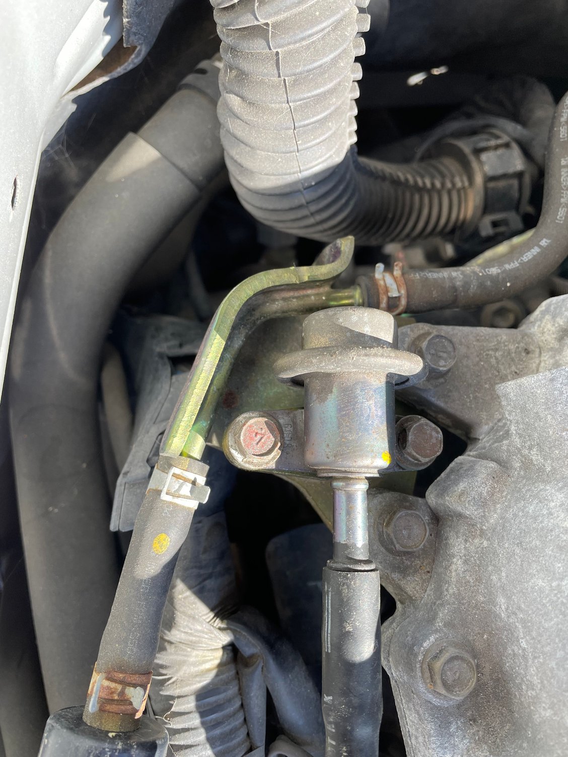

How did you test for pressure? There is no service port on the VQ, did you add a sandwich adapter?
You can test to see if the injectors are firing by installing a noid light kit to see if the ECM is pulsing them. Personally I would backprobe the ECM to install a light just to make sure the signal is sent before tearing the plenum apart.

I checked the fuel pressure right past connection where the rubber hose goes into the fuel rail. I tried to attach a photo. I did this last fall and recently with two different loaner kits. 50 plus lbs each time. This time I also had the fuel go into a can to confirm I was getting gas.
Do you recommend a specific noid kit? I will need to access the ecu. Thanks also for this recommendation.
fuel pressure check location
I will but do not want to remove the plenum.

No particular kit, you will need backprobe leads and alligator clips to hook to the backprobe, the other end you can convert over to whatever is needed for the noid lights just make sure they're Nissan compatible.
Before you go tearing into that though was the car previously running? If so what EXACTLY happened when the car stopped running.
It's really odd that you can get the engine to catch on starting fluid, you have fuel pressure, but you cannot get it to start on it's own. Normally if you lose an injector or they're a bit clogged then the engine will TRY to catch or it will run but very roughly. If it's just cranking smoothly without any signs of trying to start up that's really odd.
