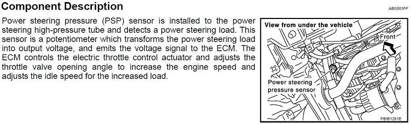

Hello! So I have an engine code saying that my power steering pressure switch is bad, and according to a few places if your idle is high this could also be because of the Power Steering Pressure Switch, (Mine idles at 1100 RPM) But I cannot find where the PS Pressure Switch is! I can find a replacement, cant find the actual location. Thoughts?

One owner 2004 G35 Coupe 6MT
These are from sections EC and PS in the factory service manual, which you can find at NICOclub.com

As I previously stated sections EC (top image) and PS (bottom). Is it code P0550 you are getting?
