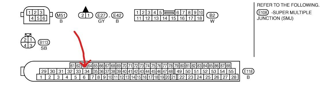

And just to verify, you do have THIS ECM harness correct?

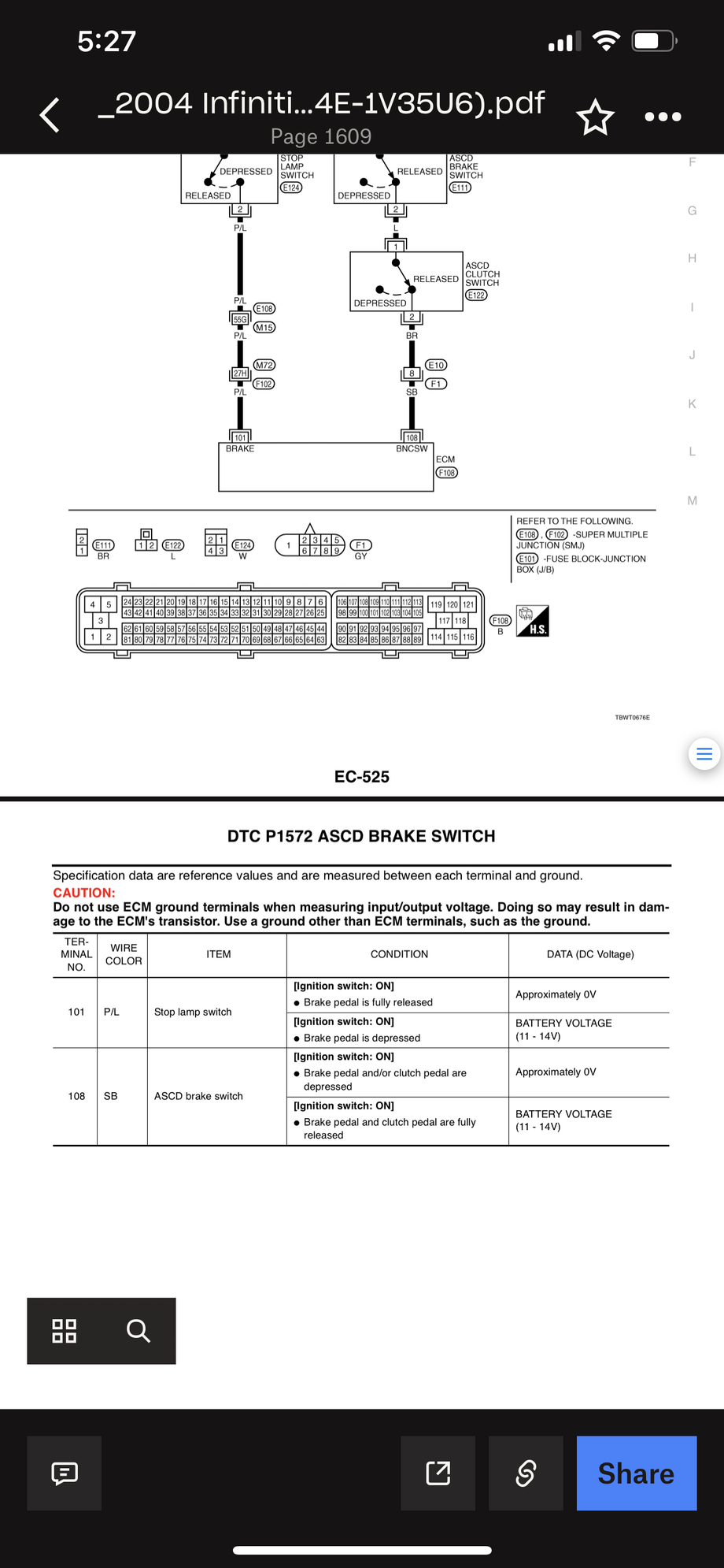

This is the diagram I have been working off from the service manual

Ahh ok I was wrong about the pin 101, it's separate from the ASCD switch.
You could cut that one yeah, are you sure you didn't look at the harness backwards though? You should definitely have a wire on that pin, pink with blue stripe. That harness layout picture is looking from the BACK of the harness where the wires go in. You do have a 6MT model yes?
