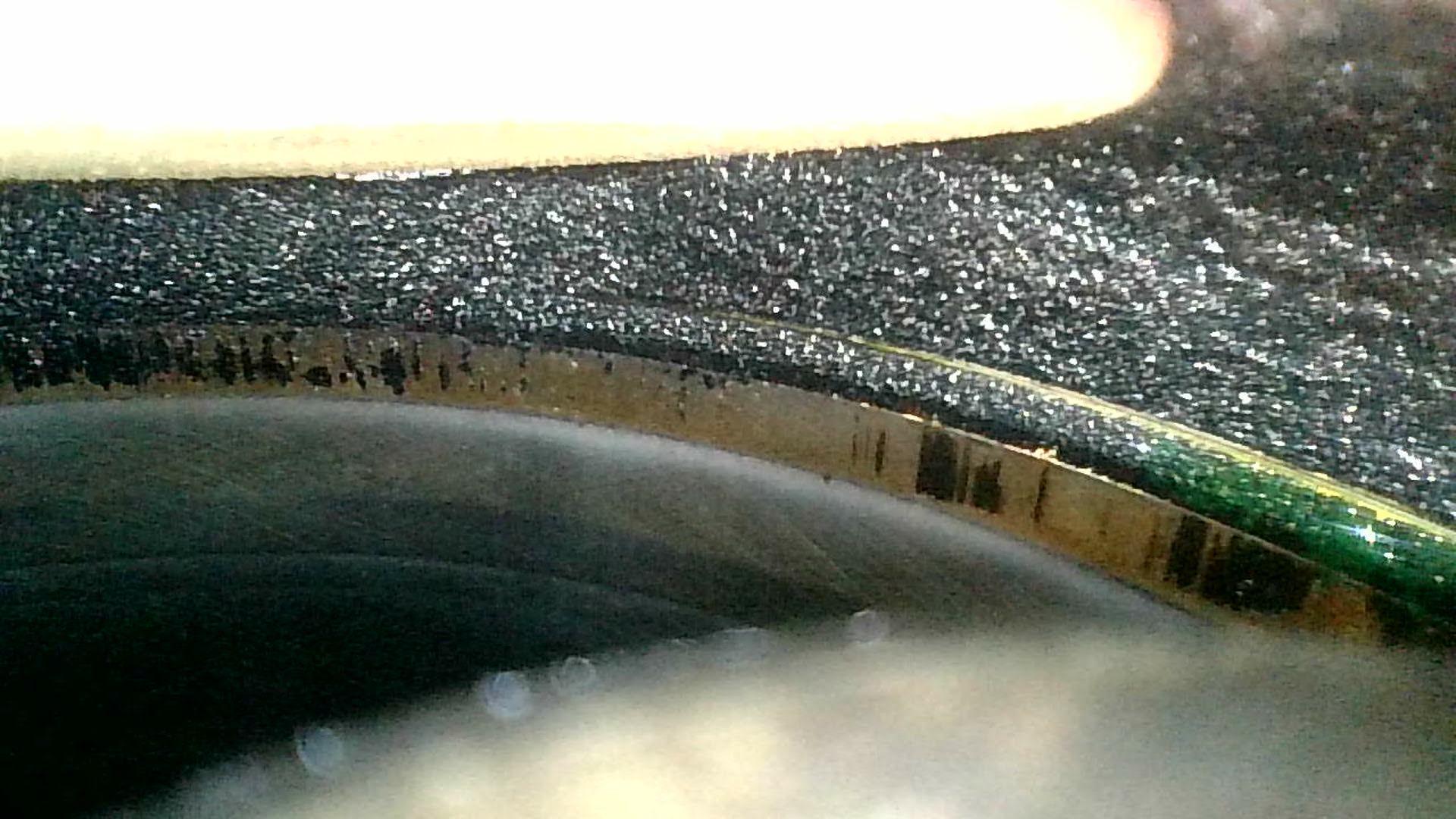

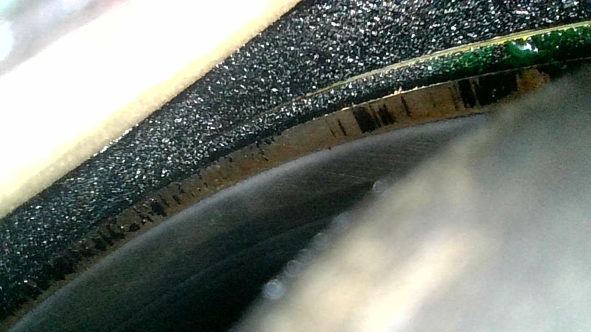

Aaaaand this case has finally come to a close! I began tear down to replace a leaking valve cover on the driver side, and in that process I decided to stick a borescope into the lower intake manifold to check for injector leakage. In that process, I peeked into the open intake valves on cylinder 3, and lo and behind, there is some coolant right on the head gasket! Maybe it needed time for the UV dye to circulate and make the leak a little more clear, because I hadn't seen it before and I checked several times on each cylinder.
Not the ideal outcome, but I'm happy to have found solid evidence that this IS in fact a head gasket leak, and that I'm not just crazy and chasing a non-existent external coolant leak.
Thanks everybody who has chimed in to offer help, and best of luck to others who are chasing these issues! Now to decide whether to sell it as is or part it out... because I'm too deep into this car to fix it.
