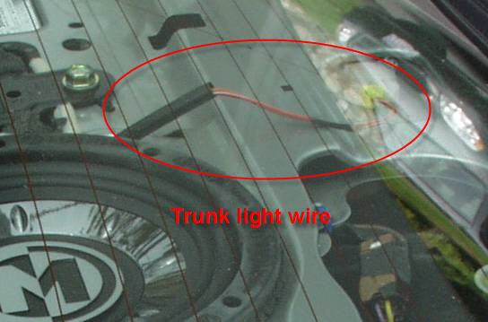

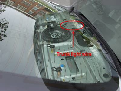

OK, it's done! So, I removed the foam that I had put in the seatbelt coil and I Dynamatted the rear deck. Just to be safe, I put some Dynamat in the seatbelt coil enclosure. I think I found the "real" cause of the noise though... I used foam tape to stick down the wire for the trunk light. My gut feel is that it was that wire that was making the noise. I can crank up full base now and there is no rattle at all!!!

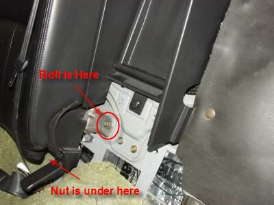

1)the 2 on the inside close by the reclining level are hard to see if at all, how and what did you use to get access to those 2 nuts?

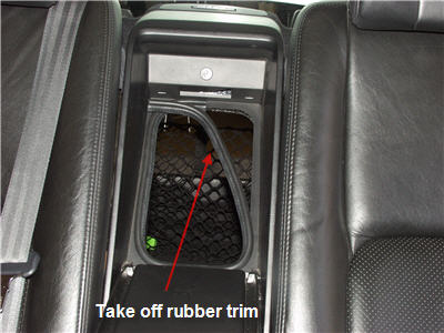

You have to remove the center console first. Remove rubber trim from trunk access hole...

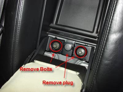

Unsrew both bolts and remove plug (just pull on the plug to remove)...
Now you can see the inside bolt. Remove both of these...

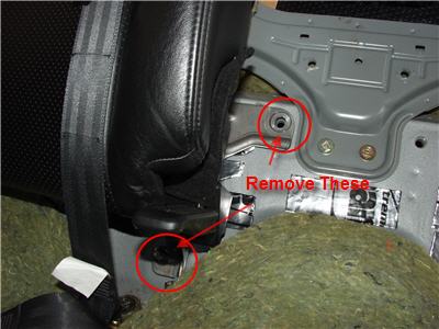

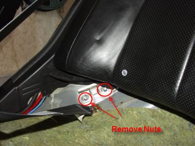

Remove the outside bolts also...
That's it - pull out both seats.

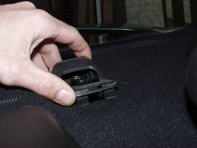

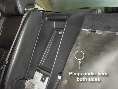

If you are doing this to get to the top deck cover, you will have to remove the upper part of the console also. Flip the matt over in the center of the car and remove the plugs (no picture of the plugs). (Don't worry that my picture shows the seat still there, I forgot to take the picture at the right time)

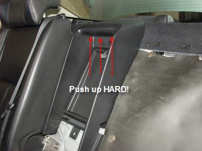

Push up on the console to remove...

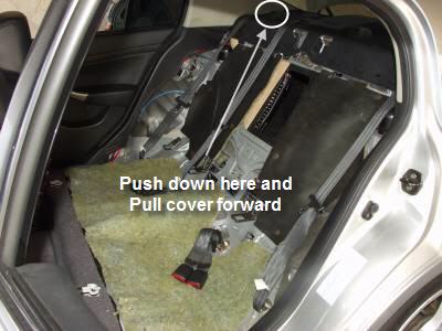

Remove the deck cover by pulling it towards the front of the car. It is held in by friction clips and the panel beside the rear window. You have to push the deck cover down where it connects to the side panel to get it to release (both sides). You can do one side at a time.

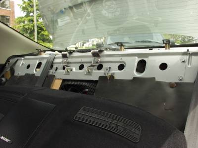

Pull the cover forward and out of the way.
Use foam tape to stick down the trunk light wire here...
I think this is the guy causing the rattle...
