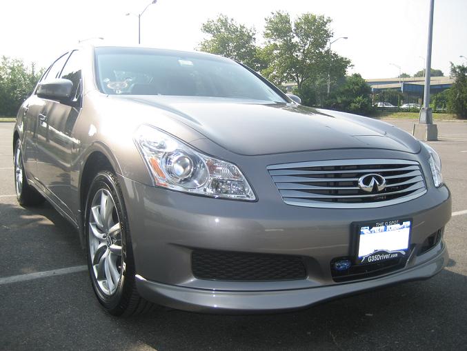

OK, installed it this weekend. Lots of rain here so don't expect any photos (yet).
The installation went smoothly and and took less than an hour. The intructions were very detailed but slightly confusing (to me). I had to visualized every part and had a good understanding before I started. I pretty much followed the direction but here are a few things I did additionally:
1) Wash the car, especially under the front bumper (I degreased it and scrubbed with brush).
2) Make 2 copies of the templates on good stock (not board though) and cuit out one full set. You are suposed to re-use two of the templates but they will not transfer easily.
3) Use a ramp or raise the front-end to get better access to the underside but you'll need it off the ramp to drill at the wheel well.
4) The plastic bumper is very soft and does not require alot of force to drill through.
5) Use clear tape to set the template (you can see/drill through it) and blue tape to mark for alignment.
6) The trickiest for me was to keep the seal from folding over as I am going around fastening the screws. Pay very close attention to this and try to keep it align; take your time.
I really liked the way it turned out. I think it improves the lines of the car. My Diamond Graphite lip was very close but not exactly my car's factory color; it is slightly lighter. The lip is edged with a thin black rubber seal where it meets the bumper. On the diamond graphite, it is hardly noticable but I wonder if it is color matched differently for other body colors. Notice on Higuma's photos above, his rubber seal is Platinum like his car.

Finally got it today.Everything Complete!!!
Specially Thanks to RICK at RiversideInfiniti.Done with installed.

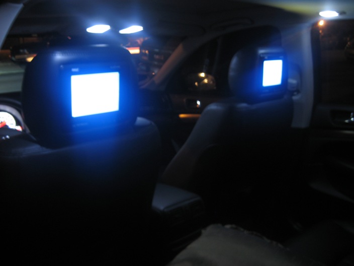

Here is Mine.just installed yesterday.Sorry for the blur~
Also i had Headrest TV installed to play with my ipod vdo.Cool stuff from Ebay selfinstalled again.

NICE Originally Posted by earth0
Here is Mine.just installed yesterday.Sorry for the blur~ Also i had Headrest TV installed to play with my ipod vdo.Cool stuff from Ebay selfinstalled again.
But we need better pics Eartho!

Hey that looks very nice Originally Posted by earth0
. You are getting some great mods done. Props to all your DIY mods.Would be nice with some better daytime pics outside though

I will take another picture after i wash my car in daytime!! I love it!!
totally different than b'fore.My next mods in BERK HFC's
