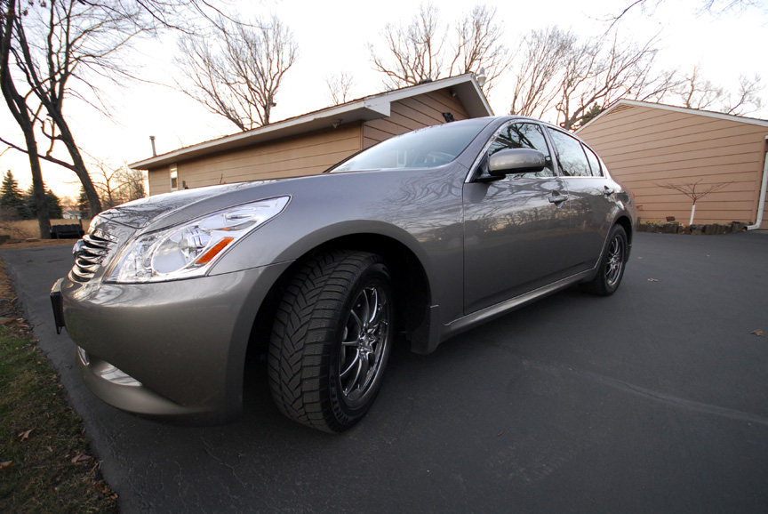

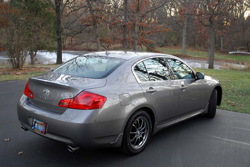

I recently put snow tires/wheels on my '08 G35XS and have a question about offset and hub centricity.
The winter wheels are BSA 17x7 with an offset of 40. I believe the 18x7.5 OEM wheels have an offset of 45. Should I be worried about this? Nothing seems to be rubbing.
The winter wheels have a hub diameter of around 66mm and the OEM wheels have a hub diameter of around 72mm. When bolted down, the winter wheels seem to be on center and there isn't any noticeable vibration at highway speeds. What's your opinion? Obviously, it's probably best to get rings/spacers, but can I get away without them? I may only keep these wheels through the winter and then get rid of them (I had them on my previous G for 3 years). Something seems a little rough at low speeds or around corners...it could just be the tread on the winter tires, but I wanted to make sure it wasn't my all-wheel drive having a problem due to the wheels being slightly off center (I know....slight chance). I didn't have this rough sound with the OEM 18" wheels.
I appreciate your input.
