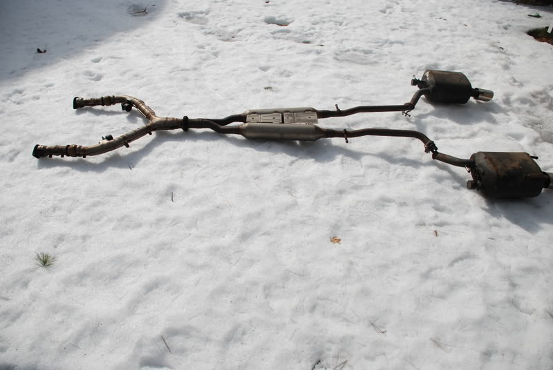

I have pics of the entire cat-back in one of csquared's threads.
I can post some here if you can describe a little better what you want to see.

Thanks Aeson for the pics here is the thread.
https://g35driver.com/forums/tech-07...exhaust-2.html
