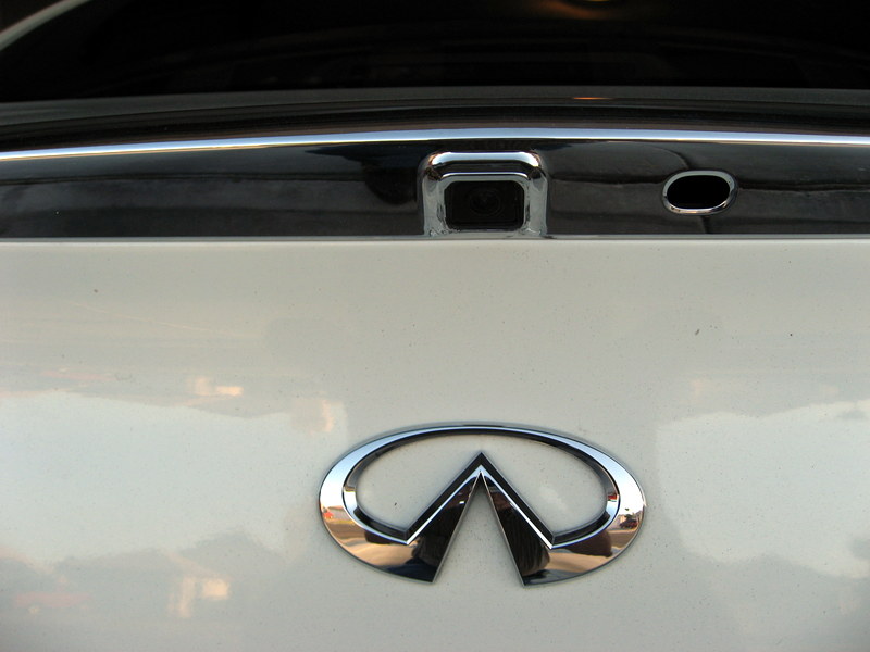

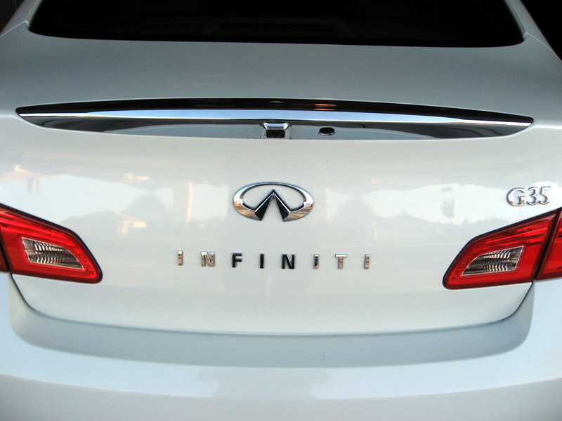

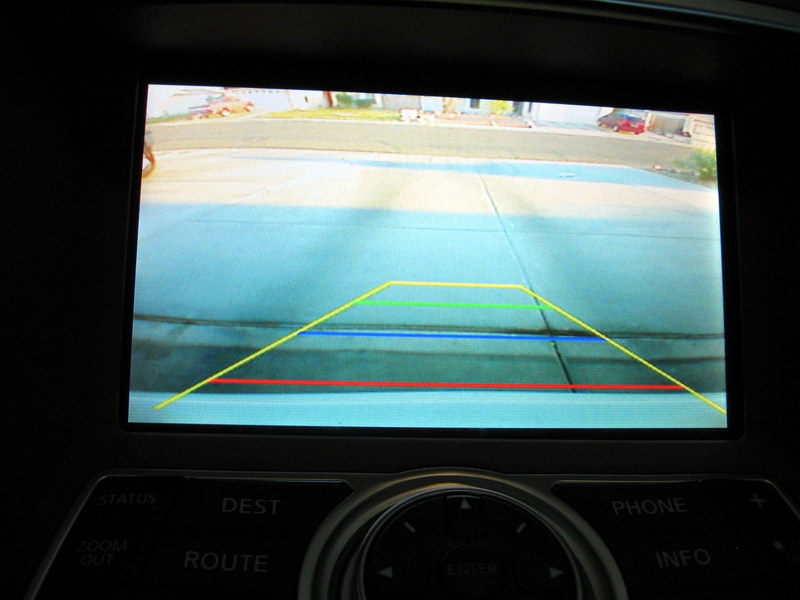

I bought a 2007 sedan with the nav package without the backup camera and decided to put one on. It's been a project but it'll "look factory" when I get it done. I bought a Navics controller and a OEM camera. I modified the camers connectors to work and bought a used finisher to put it in. I then discovered there were no guide lines from that camera. I found the OEM generates the lines from the controller which also takes a steering sensor in the steering column that moves the lines when you turn the wheel. Not wanting to go that far, I decided to get an aftermarket camera, with the lines for distance, that looked like the OEM and made a mount for it. I am very happy with this installation and the cost of it.(Controller $199, Camera $14, Finisher $75.) No one can tell it's not factory.

I would love to see pictures.

OK I'll take a couple and post them. JM
That looks great.
Would you mind letting us know where/what parts you got so that if we want to do this we can follow your lead?

That looks professional. GREAT JOB!
Its funny a guy at Infiniti told me it couldn't be done. HA!

Obviously it can be done, with a bit of hacking. You'll void your warranty though. You're going to have to get the screen to engage the video when the car is in motion, which would require some sort of hacking.
The guy said that it would cost $700 including install to do this...not worth it at all IMO, plus it isn't stock and you're hacking the computer system in your vehicle. Might as well get an aftermarket camera and a separate screen for $100.
Plus, the lines look off compared to stock...don't know why the lines are slanted. In my stock rearview camera, the lines are straight and perpendicular. Only when you turn the wheel the yellow lines become slanted. It may be the camera design and the focal length, etc...but the stock does definitely look better, IMO. With the angle with the lines in the aftermarket one, it looks like your lines are angling into the ground, not alongside it like in stock.
Look here:
http://i95.photobucket.com/albums/l1...r/DSC01136.jpg
You can see the slant lines being off in the aftermarket one.
