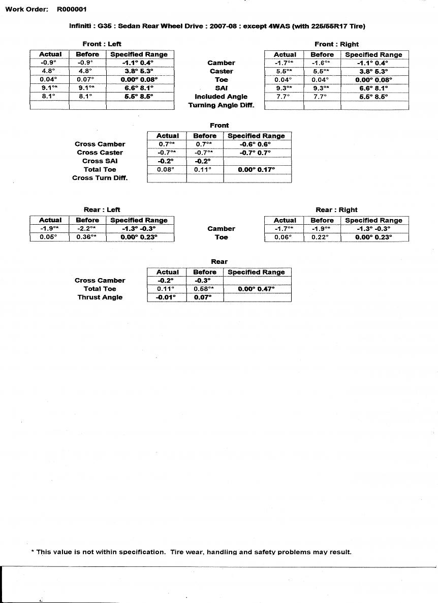

Installed my Tanabe NF210 springs a few weeks ago and gave it a couple weeks to settle. I searched everywhere and didnt find many alignment specs posted after lowering. Attached are my alignment specs.
Details..
07 G35 Journey
done on aftermarket 20" wheels
Tanabe NF210 Springs
no camber kits installed.
I am considering getting the rear kit, but wanted some opinions. Also what about the difference in camber between left front and right front?

You're just slightly out of spec, so wear won't be too bad. My car is lower than yours so my numbers are higher than yours. So far, at 5k miles since it was dropped, the tires are wearing just fine.
Might want them to get the L-R front camber within range of each other, if they can't then find another alignment shop.

The front doesnt have camber adjustments from the factory. I might have f'd up when putting the struts back in when I installed the springs. Looks like i'll have to break the suspension apart again.
