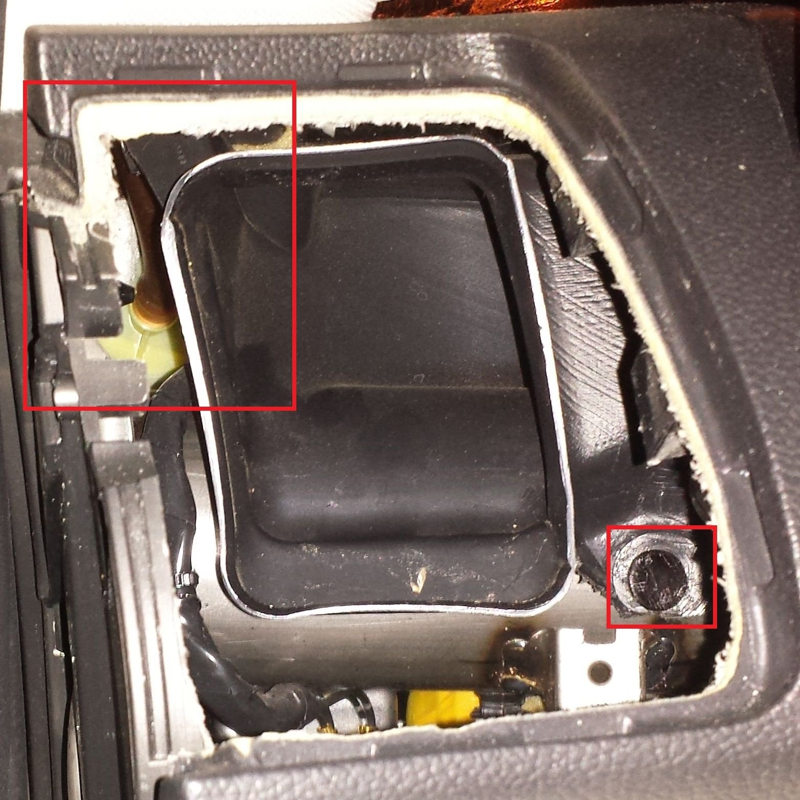

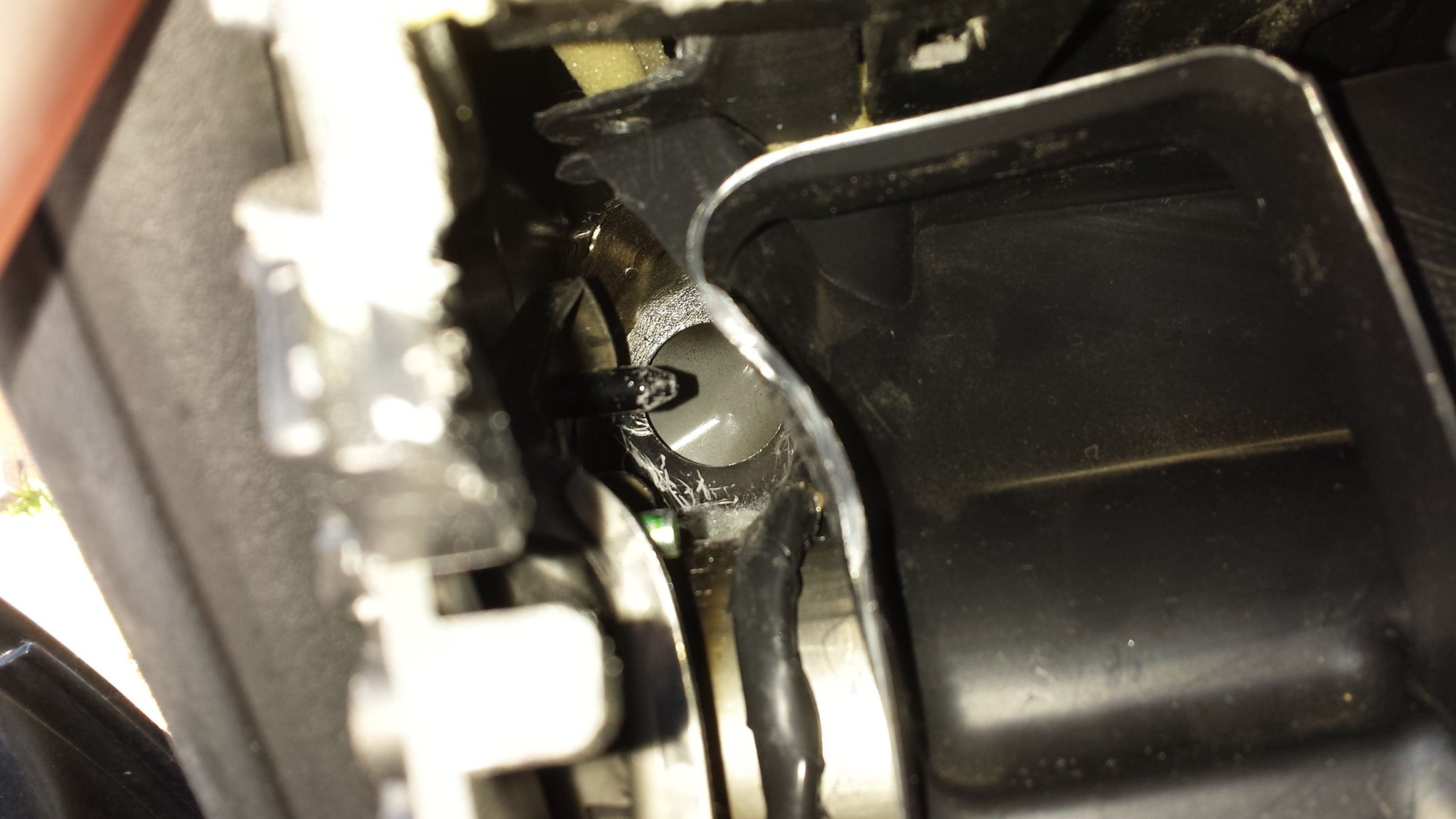

Hey Guys. New member here. Sorry to revive an old thread... but for good reason. I've owned my G for probably two years now and this is what I'm currently dealing with. (See attached)
I brought the car to Infinti last week and they had it for two days. Charged me $160 in labor to address the issue and clear the sunroof drain lines, which according to the consultant weren't really clogged to begin with. Mind you, I have an extended warranty. Which apparently means nothing.
Fast forward to this morning... and here we go again. Front and rear passenger carpets soaked. Water filled up in blue bin. A bit of water by pedals on driver's side as well. I've read a few posts about sealing the plug that connects to the firewall. I pulled the AC vent and had a look. It appears dry around the plug but the insulation is in the way. Going to have to dig deeper over the weekend, but I need a pair of needle nose first. BTW, with the AC vent pulled I still have no idea how some of you found the room to actually work in that space.
This has been very frustrating to say the least. When I originally picked up my car from the dealership after they "addressed the issue" I asked the consultant what I should do if the problem happens again. Told me to bring it back in but they would again have to charge me labor... what a joke. Again pretty frustrated so any suggestions welcome.
Attached Thumbnails G35 water leak...total mystery-20161129_163232.jpg   G35 water leak...total mystery-20161201_074520.jpg
