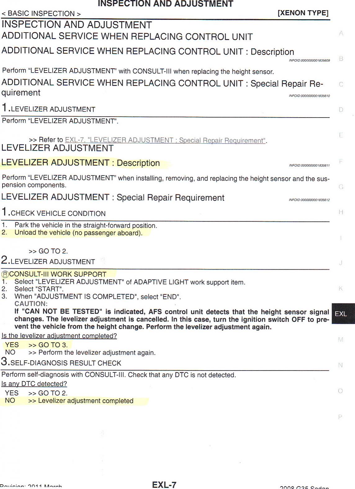

Ok I need some help here guys. I know this has been talked about before because i have read some previous posts about this. I just had my car lowered on eibachs the other day and last night was my first time driving at night. I must say my visibility now sucks cuz my headlights are pointed at the ground. I went into my dealership today for an oil change and had them look at it but they wont adjust them because of liability issues. So i went home and adjusted them myself. Started the car and my headlights lowered back down due to auto leveling. I called the dealer back and had asked them about the zeroing of the sensor box in the rear of the car. The tech had said that its set from the factory so it will always lower back down. Any help on this would be nice as i can not see very well at night. Thanks in advance for the help and responses.

So an update for sedans that are dropped. I went to Kirkland Infiniti the other day about my headlight problem and they were able to help me out. A different dealership had no idea what i was talking about and told me it was not possible to adjust the likghts because of the auto leveling. I attached a copy of the process that they do to fix this issue. Im sure a lot of you guys have just learned to deal with it but $70 and at most an hour or waiting its like new. Hope this helps out people who still need this done.

What is the instrumentational device that is used to do this?

It's called consult III some laptop that they hook into it
