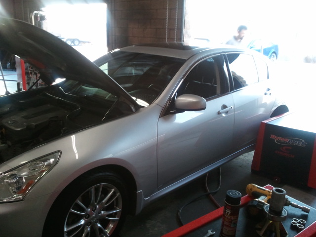

When I get home I'll attach the scans of my final dyno chart. For now you'll have to be happy with a picture of my car on the dyno.

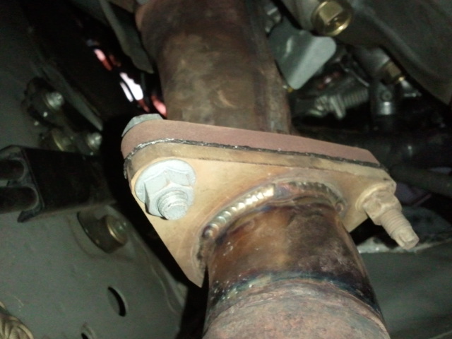

I asked Shawn Church about it and he said I might have a leak. With that in mind I crawled under my car and checked out the bolts. ONE of my bolts on each cat apparently is missing a head! There's the bolt, the nut, but there's no head on the nut. This is on the upper side of the cat where there is a triangular flange and should be three bolts total. The second picture shows what I mean. You can see the silver bolt and nut, but the brown bolt has a nut and no head. Is this normal? Do these cats only need two? Right now I'm thinking that at RPM this is causing my leak and noise. I'm going to take it back to the mechanic with two more bolts and ask him whats up.

... ONE of my bolts on each cat apparently is missing a head! There's the bolt, the nut, but there's no head on the nut. This is on the upper side of the cat where there is a triangular flange and should be three bolts total. The second picture shows what I mean. You can see the silver bolt and nut, but the brown bolt has a nut and no head. Is this normal? Do these cats only need two? Right now I'm thinking that at RPM this is causing my leak and noise. I'm going to take it back to the mechanic with two more bolts and ask him whats up.
It's perfectly normal for a threaded stud.

^ whs, that one bolt is threaded from factory and those numbers are in fact 'optimistic' since every dyno reads differently, realistically speaking if comparing to other dynos that have same mods and tune you would be around ~280-290whp since you have MT which has lower drive train loss.
