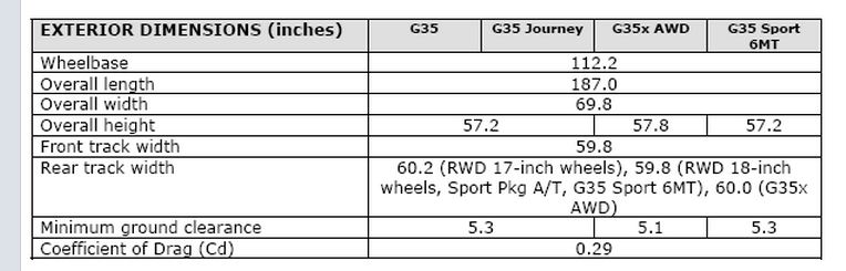

The 2008 G35, G35 Journey and G35S sedans all have the exact same ground clearance and vehicle height.
Attached Thumbnails Does G35S rides lower with stock sport suspension?-2008-g35-sedan-exterior-dims.jpg

From: Somewhere
^good to know, i guess its just the 18s then that make the S look a bit lower

not lower. 07 and 08 sport only got different sway bars brakes and a limited slip diff. no lowered suspension
