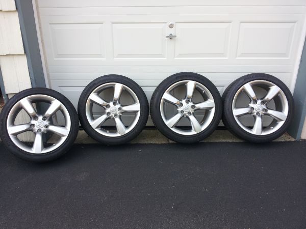

I am a NOOB when it comes to wheels, but I am working on a deal to get these for just $600 with good tires
Is it a good deal? Will they bolt right up to my 07 g35x? Anything else need to be done? TPMS compatible?

from what i read. make sure you use the same tire diameter on both front and rear

Yes, they will. They'll even fit over the Akebono's.
As stock mentioned, just make sure the tires are the correct size. OEM Z sizing usually has shorter fronts than what's spec'd for G's.
