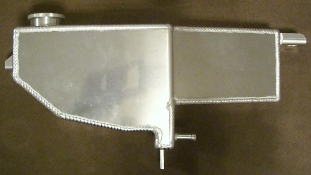

If it is the tank, you can replace it with one of my custom aluminum tanks that will NEVER leak. PM me if you are interested.
