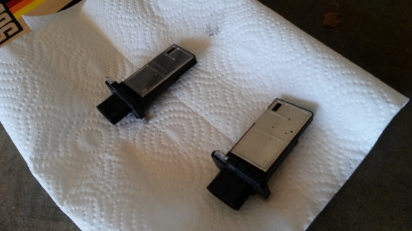

The MAF's were also relatively clean. With how easy they were to clean off it wasn't a problem but when I sprayed em down only a minute amount of dark liquid came off. My car has the stock air filters (dry type) so that might have something to do with it (as I hear oiled, or over-oiled filters can cause MAF issues).

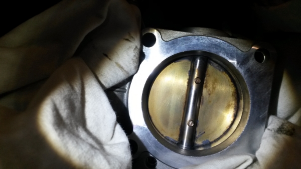

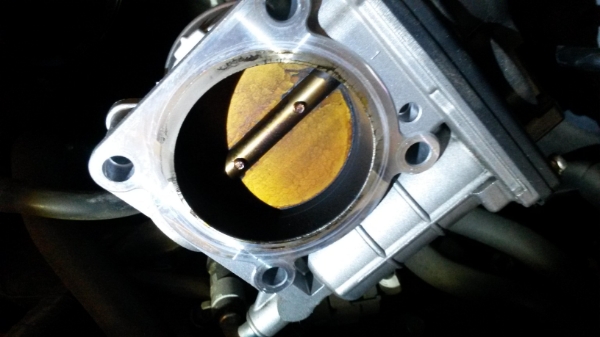

The intake side of the throttle body was plenty clean, as expected, but the backside was definitely gucked up.
I would not recommend using the MAF cleaner on the throttle body, it just isn't powerful enough. The TB cleaner worked well but I can see why it shouldnt be used on the MAF's themselves.
I did as recommended and unplugged the battery but left the TB's connected. I moved the butterfly valve all the way open and cleaned it thoroughly.

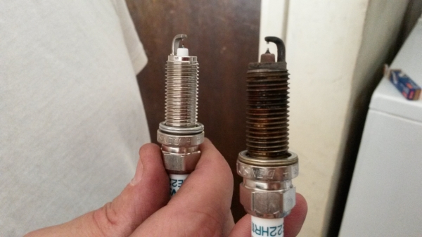

The spark plugs looked good, worn, but fine. No guck on them, no blister white, so everything was fine there, but I am still glad to have new ones.
