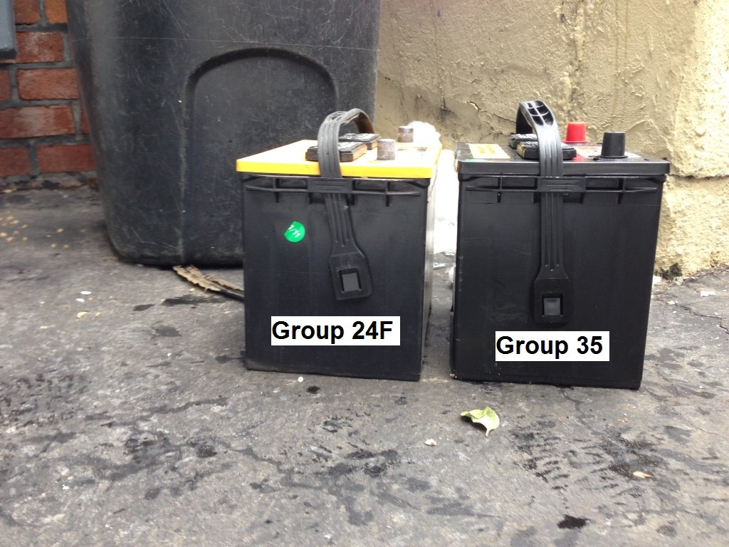

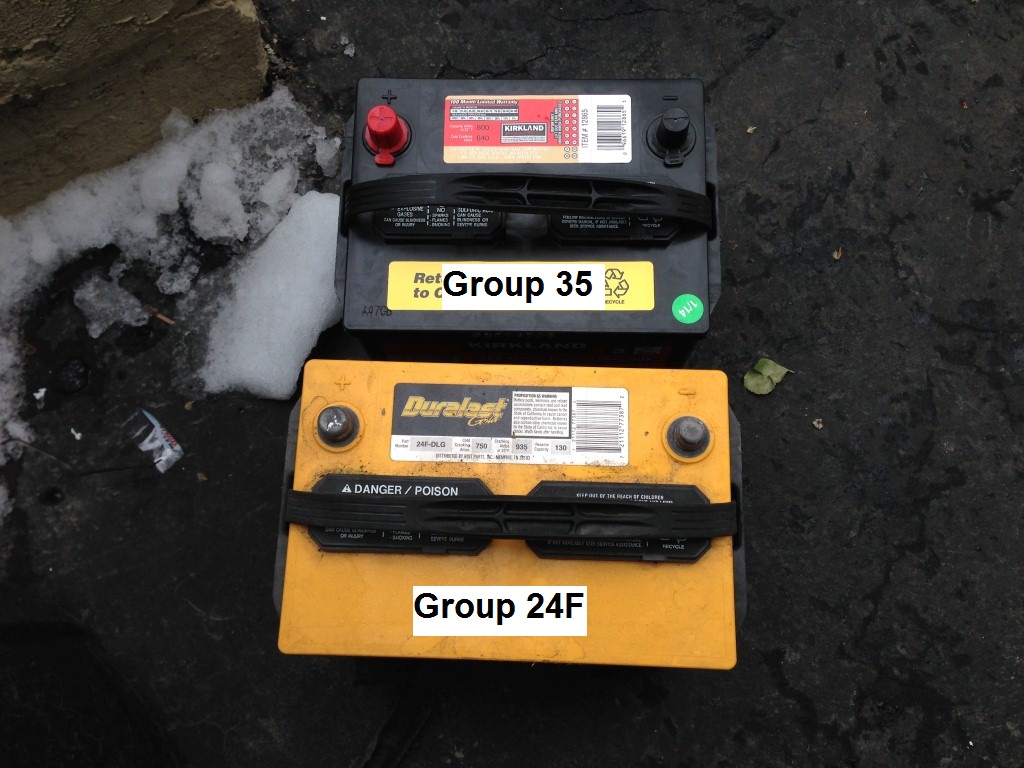

My battery was up in age and I noticed that it would turn over slower and slower every cold morning so I figured I should get a new one before it's too late.
I looked thru this site to see which size battery we use and there seems to be some confusion in some threads on whether it is a Group size 24F or 35.
After a bit more searching I found that the correct one is Group 35 (even though the costco booklet showed 24F for my 2007)
Here are a couple of photos to show the difference between both. Apparently the previous owner had a 24F installed (wrong one) so I purchased the correct one. See the difference in sized below.

Your old 24F has a lot more cranking amps though. I wonder if that's because it's a Duralast Gold or if that size just holds more--did you happen to see a Kirkland 24F there?

Yup I saw 24F kirkland batteries.
As far as the CCA...meh car starts just fine in the 20 degree weather we had this morning.
My car starts a lot faster now and notice the car seems more "alive" and interior lights a tad brighter. Can be all in my mind though.
BTW current price of Kirkland batteries are $74 for our cars
