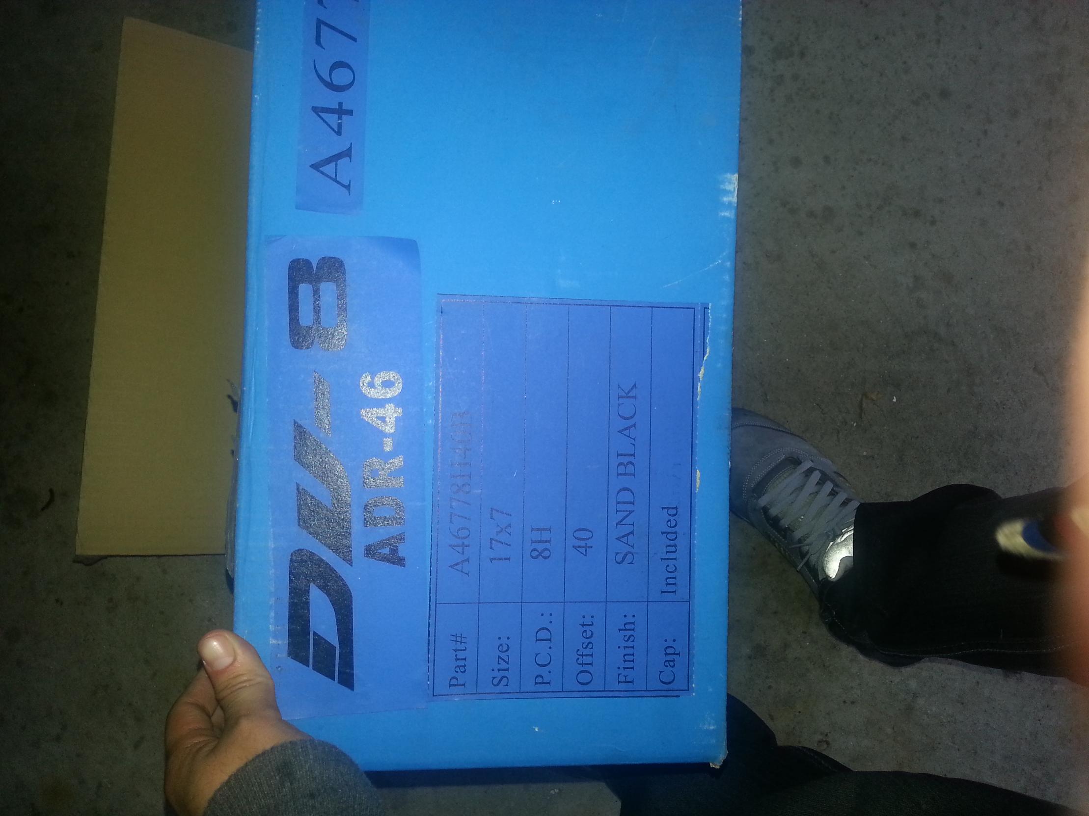

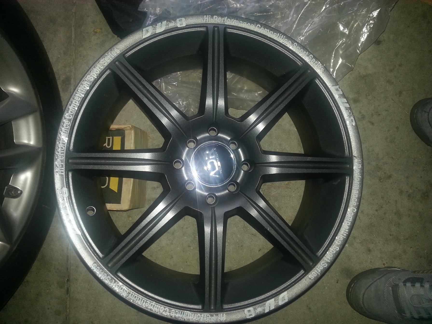

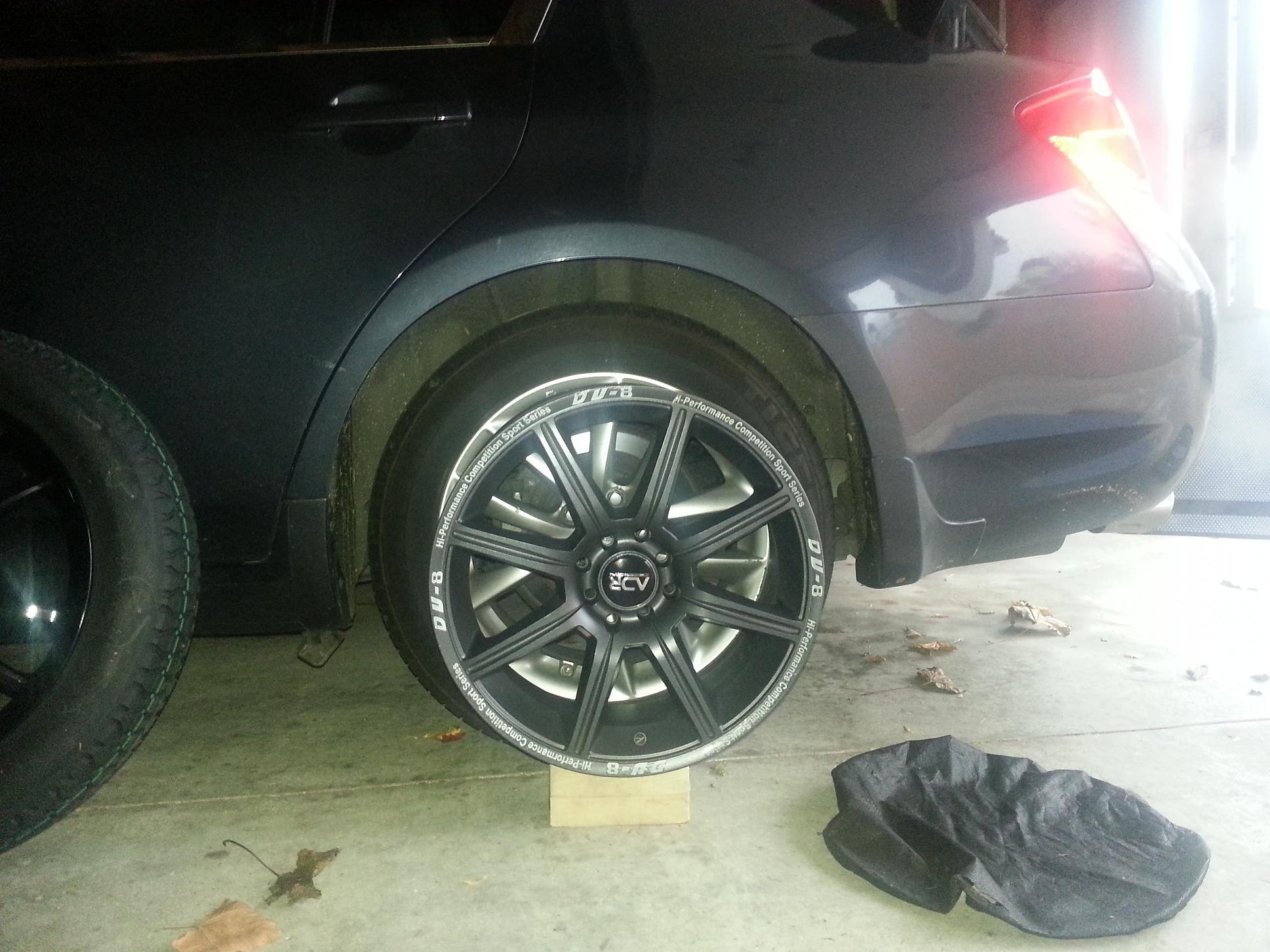

I have a set of tires that i purchase while back when i first got my car due to not having to get into my car and work on it. Now i want to do it for summer. I was wondering if any of you had seen or used this tires before? and what tires are good for them? im thinking 235/55/17 in the back and 225/55/17 the front. I was thinking of some Michelin pilot sport.... im also dropping the car with eibach pro kit

Haven't seen those wheels before but a quick google shows they've been around for a long time. You can run up to 245s on a 7" rim so I'd go 245/50/17s all around to stay closest to OEM diameter or the 225/55/17s on all fours. That way you can rotate all four tires regularly to get better tread life. Going form a 225 in front to a 235 in back won't make much difference and you won't be able to rotate them, except side to side.
