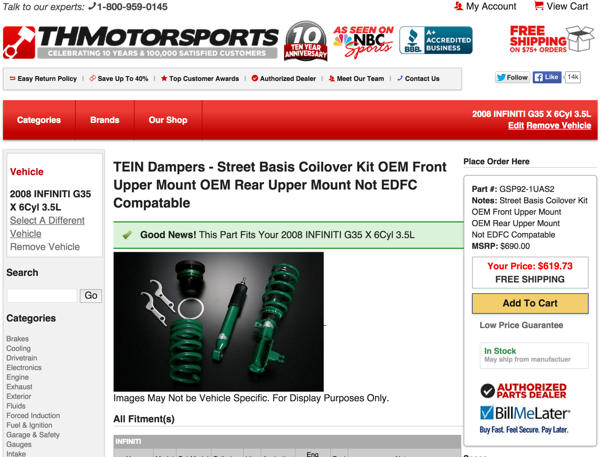

Tein Basis coilovers are a good option and use the OEM front hats (a source of noises on many coilovers are the front non-OEM pillowball hats). They go for around $600 from TH Motorsports
http://thmotorsports.com/tein/tein-d...i-1827064.aspx
These will be a lot better than a lowering spring on an OEM shock.
Got these last year for $800, kind of pissed they dropped $200 in 1 year but they are treating me great.
Keep in mind these are for RWD cars. Not sure what yours is, but for us X owners, options are severely limited.
Are you sure because it says they do fit the x model. I only ask because I plan on getting them for my G and I don't want to order them if they don't fit
They don't fit. That's a mistake.
