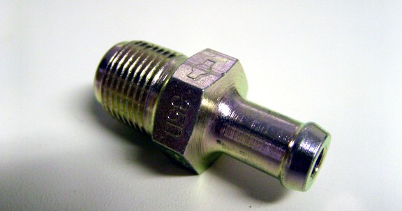

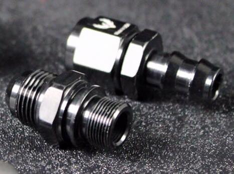

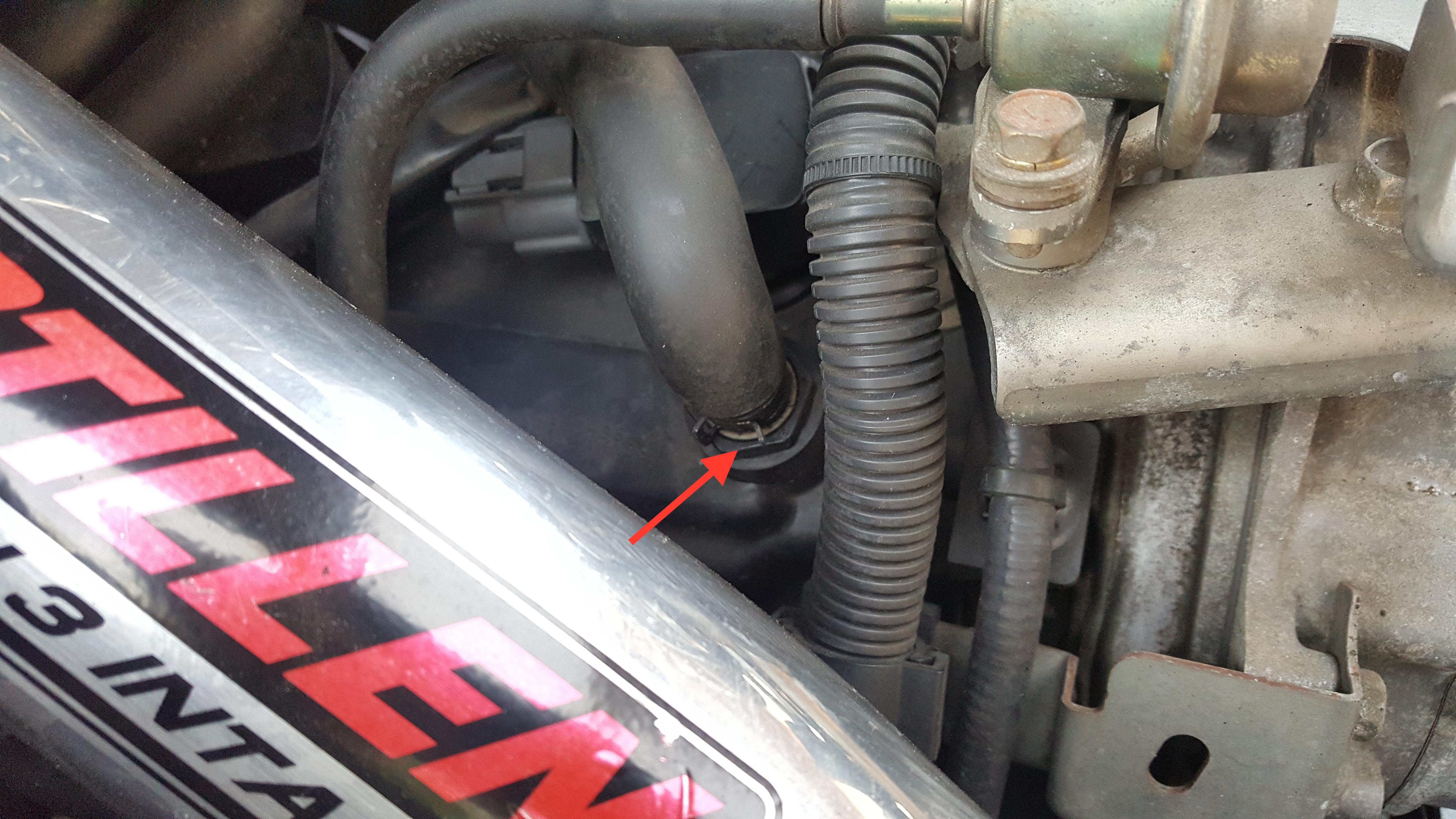

Ive been meaning to install my oil catch cans for a while now and i need some help, I want to replace the current pcv fittings with some AR fitting i just do not know the correct size that will replace the current one. Let me know if im correct i will be removing the current breather hose thats in the front that connects to both intakes and one hose will go to the intake and another to the pcv and connect to the oil catch can. I will have to cap in the rear of the manifold as removing the passenger side hose that connects to it and doing the same there.

i was looking at the EPS pcv delete system. and its like $80. i was just thinking about going to auto zone (or wherever) and buying one of those little filters and some plugs and other things to make my own pcv delete system. I was thinking about drilling out the old pcv valve and connecting a vacuum hose to that to connect the filter to. Then just plugging up all the other intake holes and manifold holes. Sounds way cheaper to me than $80! any ideas?
