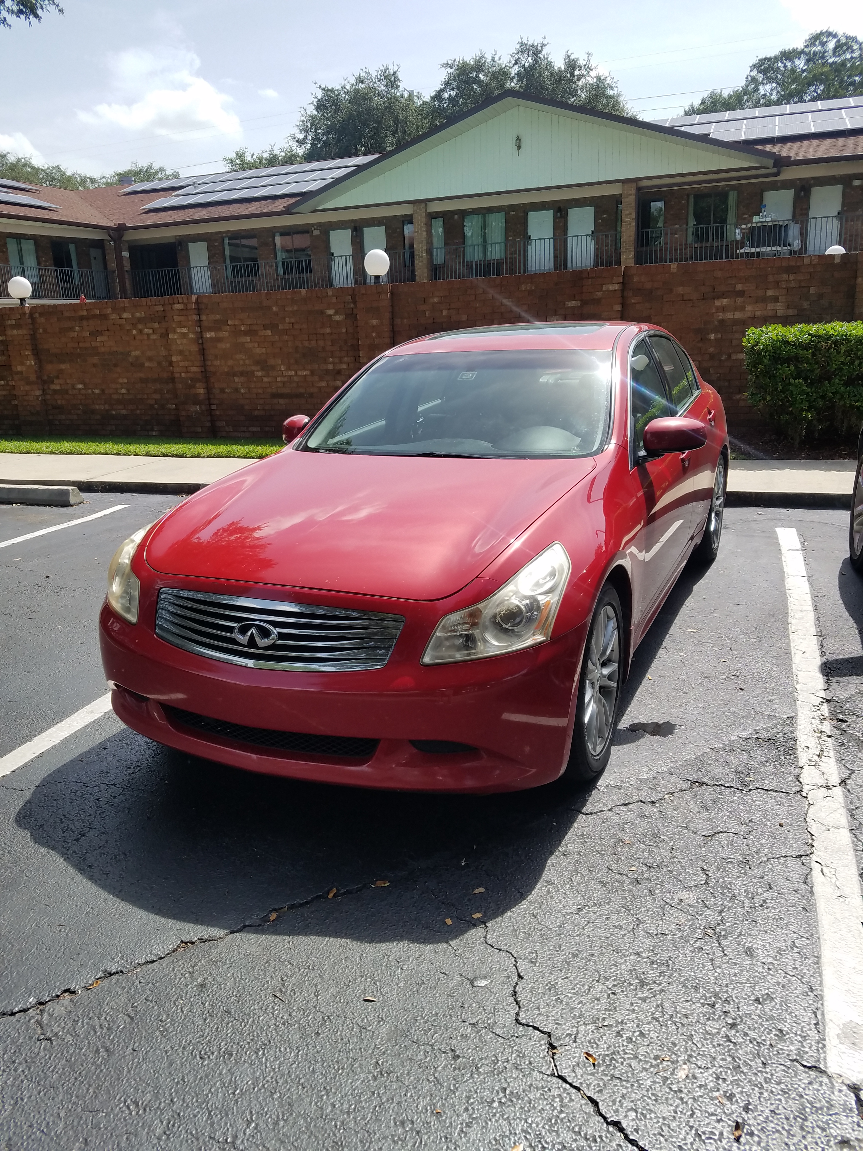

Detailed, headlights wet sanded and tints added.

Looks great, nice scenery too, where was the photo taken?
At the front of my friend's housing complex. Could use some paint correction still but not bad for 140k miles in the southern sun.
