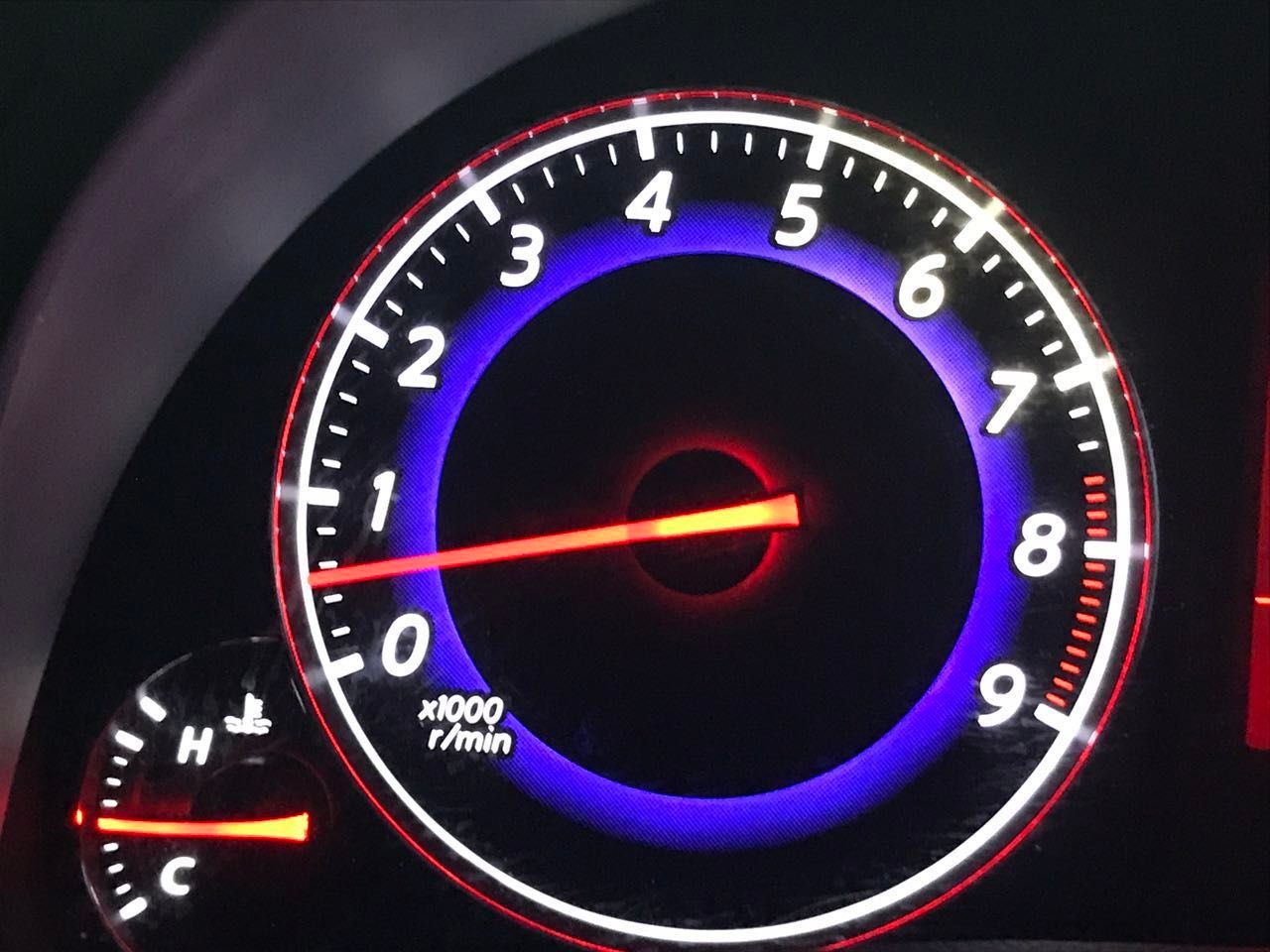

Hi everyone, I am new here. I am from NZ. I found a problem with my 2008 Infiniti G35(Nissan Skyline 350gt). it has done around 82000 miles (132000KM). I bought the car from a dealer 2 weeks ago. Recently I found out my car shakes a little bit when idling. And the rpm is pretty low around 500rpm. I am thinking may be I need change my spark plug. If I step on the brake and press on the accelerator a little bit and let the engine speeds up to 600 rpm or above. Magically the shake will disappear.
What do you think of this problem? Is it a big deal? Any one happens to have the problem before?

Thanks for your advice. I followed a YouTube video which shows how to do Idle Relearn. And now it feels much better. The engine remains 600rpm which should be as normal.
