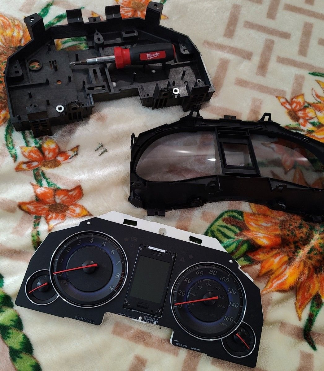

I have the same issue in my 07 where the gauge cluster was beeping fine when the door was open or turn signal was on but now, it doesn't beep at all and I LOVE IT!
I hate that annoying beeping sound when the door is open so i hope it don't come back!
But for those that miss that annoying sound, the only solution is to replace the 'beeper' device on the gauge cluster board marked in the RED circle.
2007 G35 gauge cluster.
