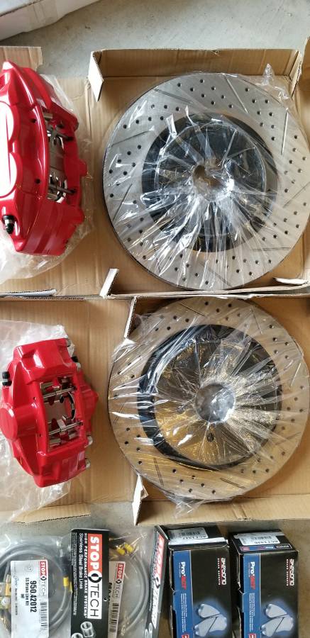

So I've been wanting to upgrade to bbk for a while now and i found a guy selling a the complete setup for remarkably cheap compared to retail price on akebonos. Only problem is that they are for a 2016 Maxima. Is there any chance they can fit in my G? i feel like the only problem would be the rotors but i could be wrong, any advice will help thanks! included is a pic of the entire setup that he is selling.

Well the brakes list as interchangeable between the G37S, 370Z, FX35/45, M37S/56S, and Maxima so I THINK they should work but you might call one of the vendors like Z1 just to verify.
You will still need the adapter plates for the G35 as well as the brake lines I think so get prices from them while you ask about the parts interchange.
