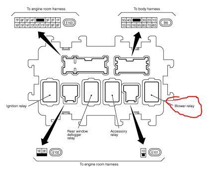

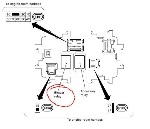

The problem is almost ALWAYS the relay on the BACK of the Fuse Block J-B which is located in the driver footwell, remove the entire trim piece not just the little access window. Disconnect your battery. Take out the couple of small screws holding the fuse block down, I think they're 8 or 10mm, can't remember. Lift up and turn the fuse block a little and you'll see some blue relays located on the BACK of the fuse block. Autozone carries the actual OEM Nissan relay but since you're dealing with freezing temps already I'd just throw ANY brand of relay in to get the system functional again.
Since you didn't specify whether you have a sedan or coupe I'll post pictures of both fuse blocks...
Here's the coupe
And here's the sedan

Absolutely correct. I removed fuse box and pulled bottom relay as others have mentioned. Then did quick check and blower was working immediately. Paid 40 bucks and about 5 minutes of my time.
So glad for forums like this and the guys who take the time to help others. Can only imagine what Infiniti would have said the issue was and fix would cost!!
