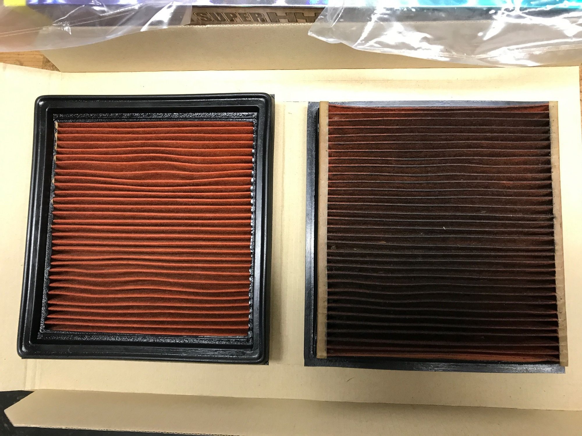

Stock Filters 22k miles. LH back side, RH front side.
Part number shown on side 16546JK20A
I checked out Motorvate video too and I don't think those were stock filters he made first run with. I may be wrong but when I bought stock air filters from dealer for my car some time ago they were oiled pleated filters. So were the ones I was replacing. Not sure if material is paper or cotton but they definitely have oil in them. I get it on my fingers when handling them. I have a 2008 G235S but G37's use same air filter 16546-JK20A. One in video looks like a WIX or Fram paper air filter or something. Here is photo of my stock air filters with ~22k miles one front and one back shown in photo. They do not have orange surround and filter material is burnt red, not yellow. If those orange and yellow filters were used in base run, they are not stock.
Thanks for pointing that out, I'll have to recheck the motorvate video.
I still have my oem filters and thats what they look like, however I think oem, Fram, purolator all are pretty much the exact same thing. IE. a restrictive paper filter and perform about the same, although I've heard oem has more pleats per square inch allowing them to filter better than some others.
P.S. by the way there should not be any oil on the paper surface, or at least they don't come pre-oiled when you buy one.

I thought they were oil impregnated when I got them but not 100% sure about that.
