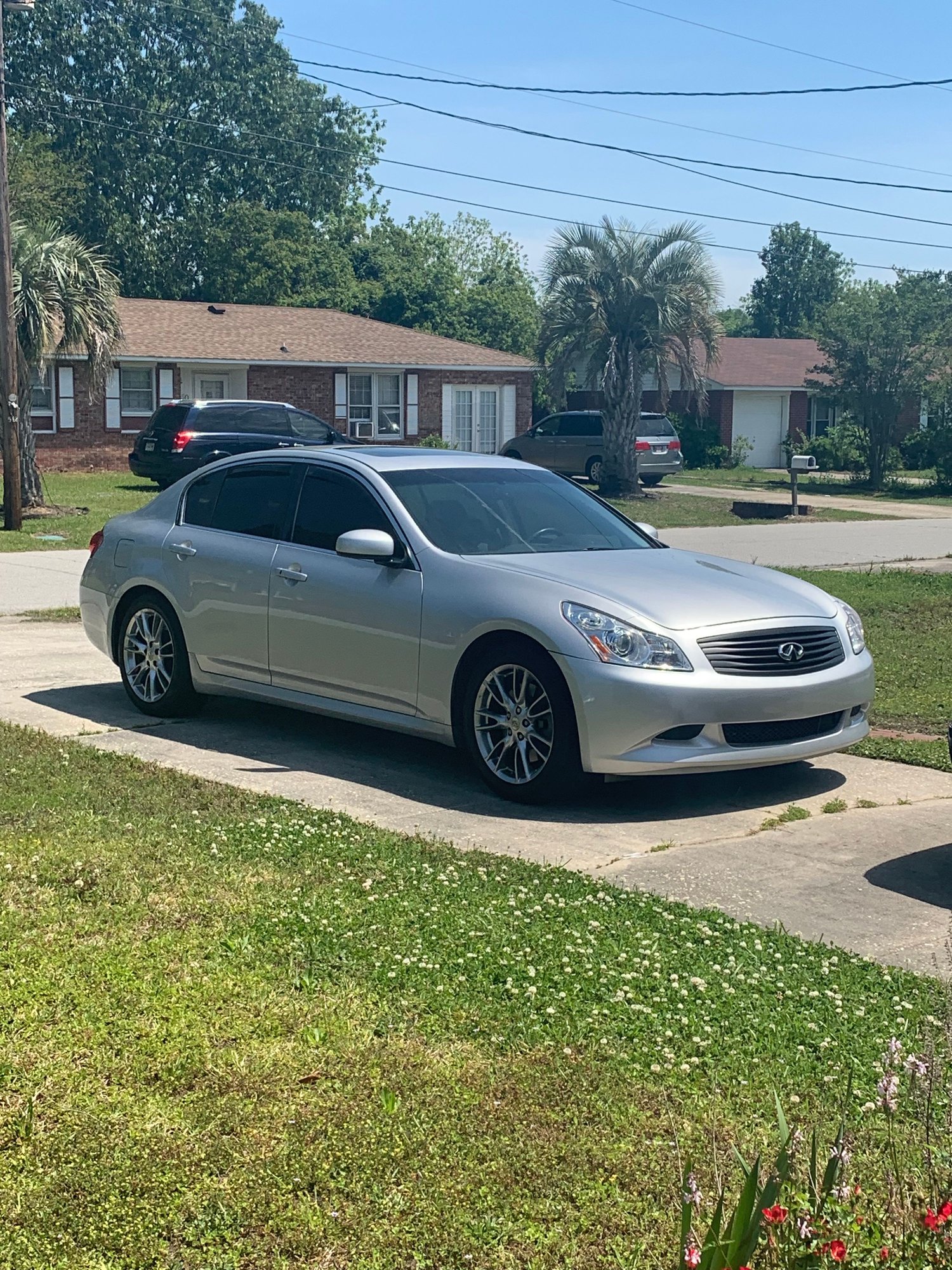

Hi so I'm looking for new wheels for my 07 g35 sedan. I currently have the stock 18s on them and plan on sticking with that size. I'm really looking for a flushed fitment, what has worked best for you guys? Any tips or words of advice for a newbie to the car scene?

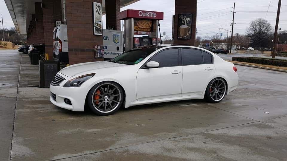

A key feature to watch out for is the spoke design to ensure it clear your calipers. From your pictures, it looks like you don't have Akebono calipers so you'll have a larger selection, but keep in mind if you do want to install them, that not all wheels clear it.
in terms of size, it depends on the style you are going for. Do you like the meaty look and prefer having as much usable grip as possible, or do you like the stance look?
setups I've ran before:
Advan AVS Model T6
18x8 +30 245/45R18 1
8x9 +35 275/40R18
Forgestar CF10
19x9 +35 255/40R19
19x10 +42 285/35R19
SSR MS1
19x9 +24 245/35R19 (ran a 15mm spacer to clear the calipers so +9 effective offest)
19x10 +29 275/30R19 (ran a 3mm spacer to clear the calipers so +26 effective offest)
I do not recommend this tire size as it is 1" shorter than stock diameter and they are like rubber bands, I bend two of my wheel lips going over road construction.
Rennen Blue Label C10
20x8.5 +25 245/35R20
20x10.5 +35 275/30R20
Old Apr 26, 2019 | 12:22 PM
Kuynichan's Avatar
Joined: Feb 2019
Posts: 22
From: South Carolina
6MT G35 Sport Sedan w/ Tech Package
I like the meaty look, not really into stance, but the second picture with the 19's look really good
