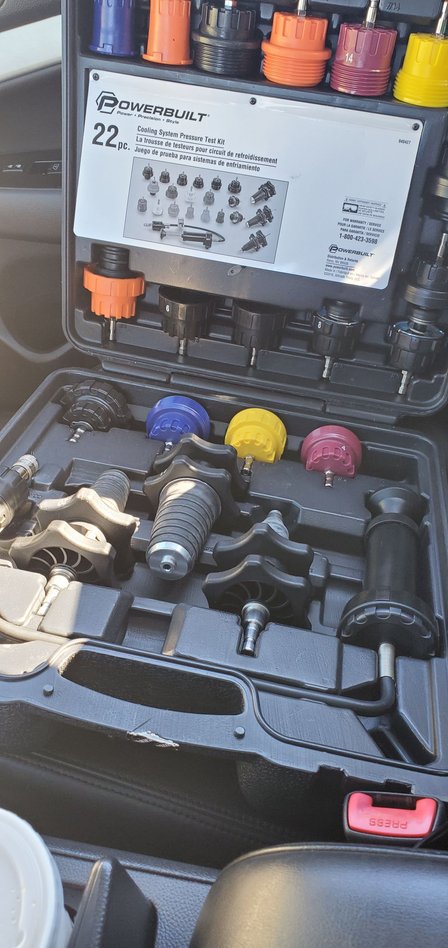

OK so both of my rad caps (caps I bought in the past) are slowly losing pressure according to the kit. Waiting for car to cool down so I can text the system and the new rad cap from the dealer
Edit.

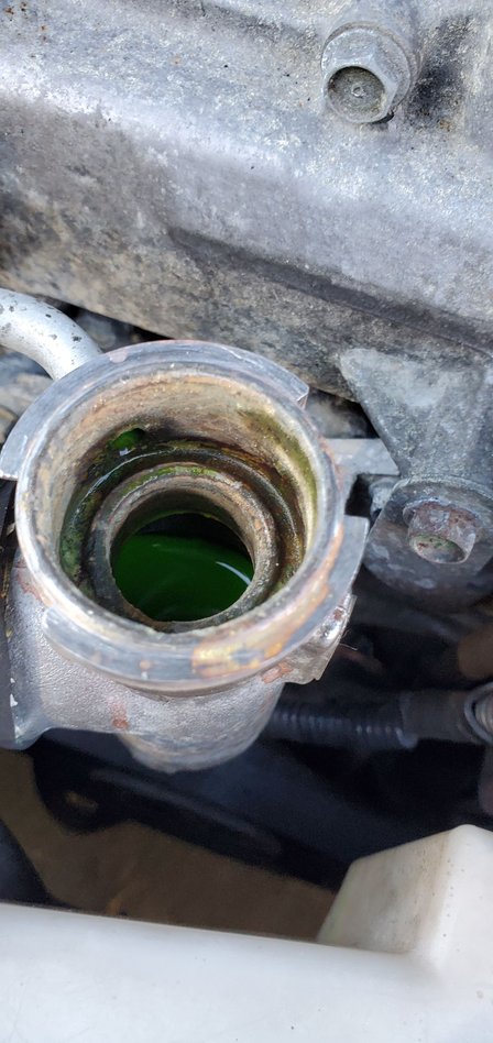

Oem cap showed no leaks, tested system but couldn't build pressure due to air leaking at the pipe the radiator cap attaches to. I was using cap number 9 in the powerbuilt cooling system pressure tester kit.
Upon further inspection I noticed that the pipe opening has seen better better days
Could vapor be escaping from a poorly sealing coolant pipe?
Is the adapter that I'm using the wrong one? (just checked it says for nissan)
Also now that I think back to yesterday I was attempting to use my lisle spill free funnel to eliminate the possibility of air in the system and it started leaking from the rad cap adapter. Did the same today as well. Didn't do that beforehand. Coincidence? Hmmm
