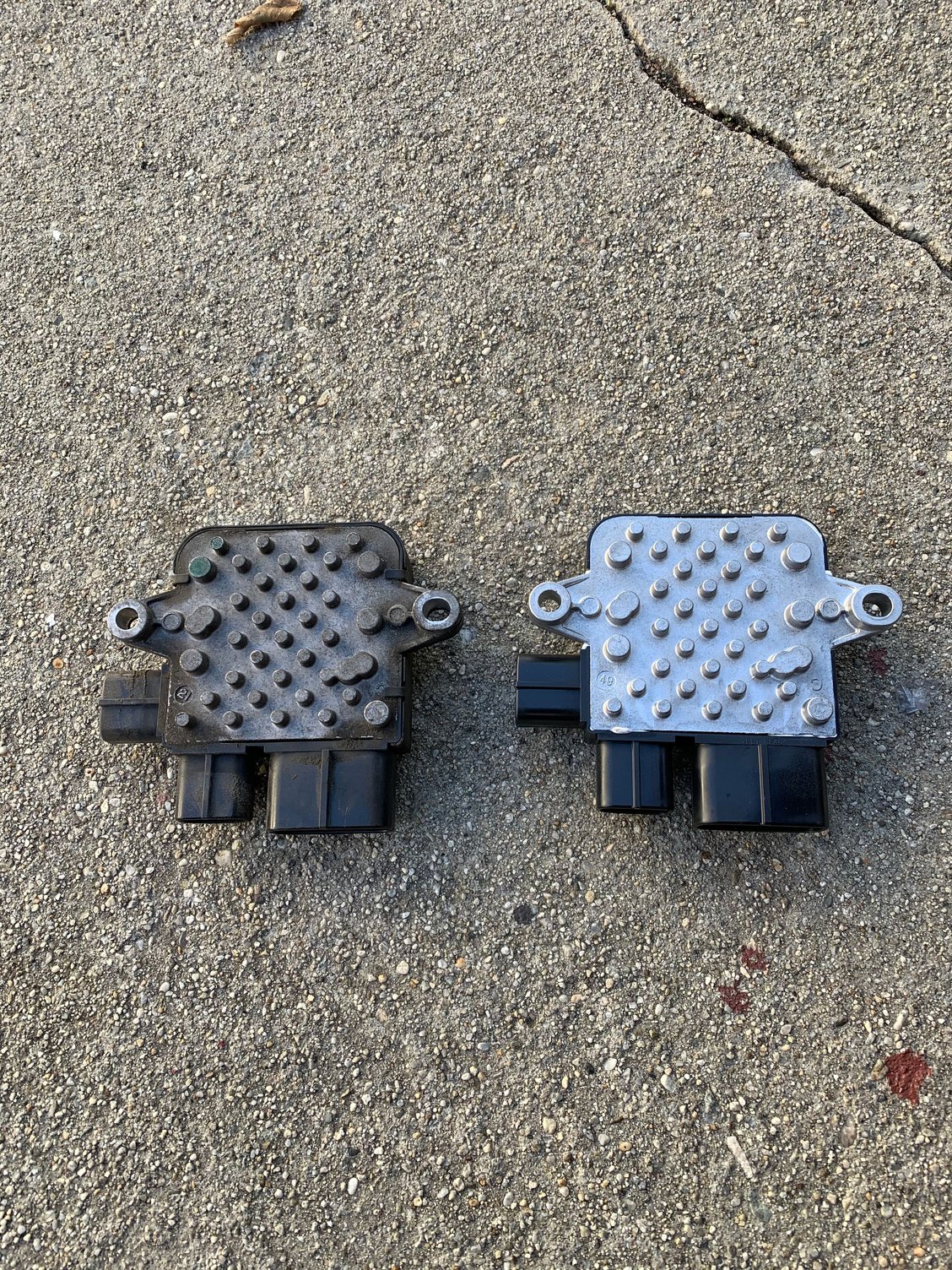

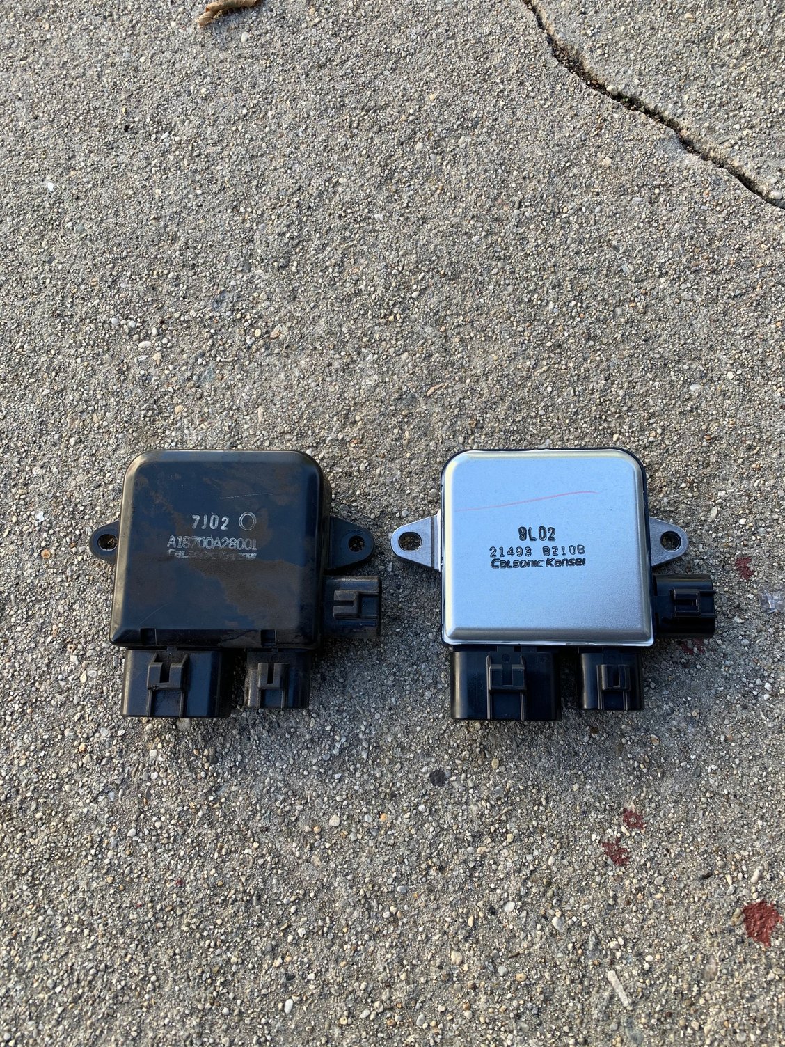

Any resolution on this? I have the same issue on my 08 G35S 6MT. I'm about to just buy a new cooling fan control module and swap it out.
UPDATE - Purchased OEM FCM from dealer and replaced it today. The issue is gone.
