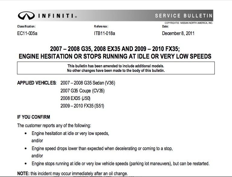

Kinda sounds like an issue I had about 9-10 years ago before getting a flash.
File Type: pdf

I haven't seen that TSB but it makes sense. On the 07'-08' G35X cars the first ECU's are a A,B,C revision. I changed my brothers 08' G35x car from a "A" revision ECU to the latest "D" revision ECU and there were quite a few differences. It even rescaled the gas pedal so the car wasn't so jumpy off the start. I also hear there is a TCU update from the 1st gen V36 models too.

I had several flashes over the years.... the one above, the over-sensitive throttle, and another for radar cruise throttle going down hill. I can't remember if I am on C or D at this point.
https://x.infinitihelp.com/forum/loc...s.php?catid=71
File Type: pdf
