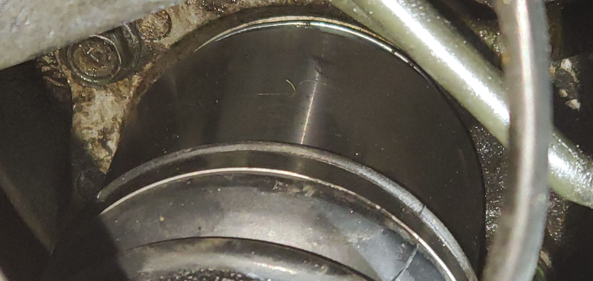

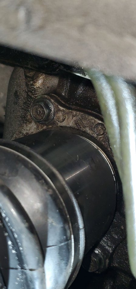

Hi All
I am new to this forum, but hoping I can get some help. I have recently taken on the task of replacing the inner tie rod, outer tie rod the upper and lower control arm the sway bar link and the front axle on both passenger side and driver side, I was able to get everything out and back together but when I went to test driver it it felt like the passenger side axle was popped out of place but when I jacked it up it appears to be in place, But something isn't right. Any suggestions as to what I did wrong would be appreciated
Car is a 2008 Infiniti G35x awd sedan

Is it sitting flush against the transfer case?

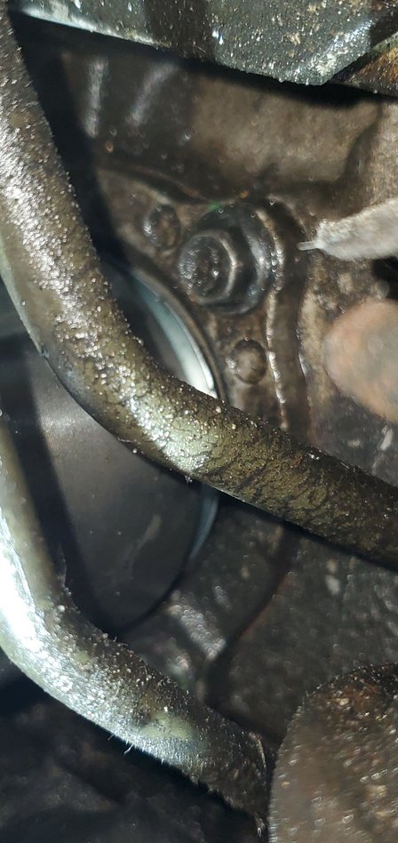

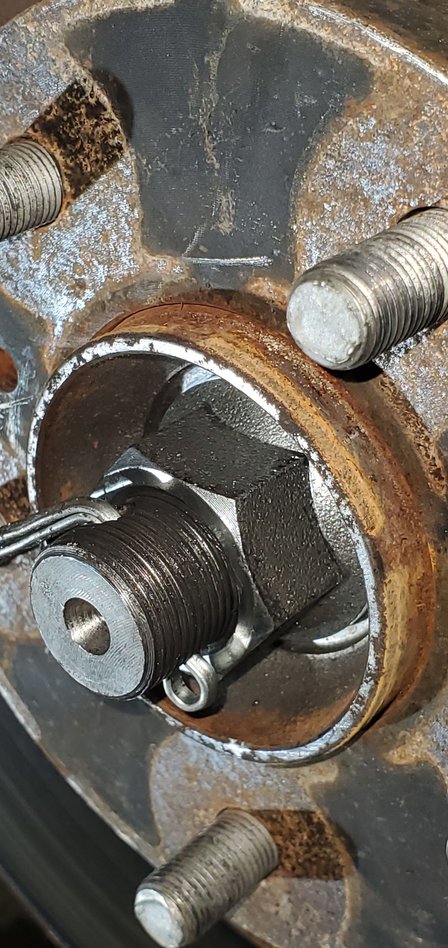

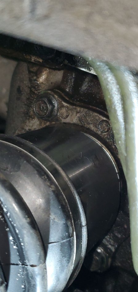

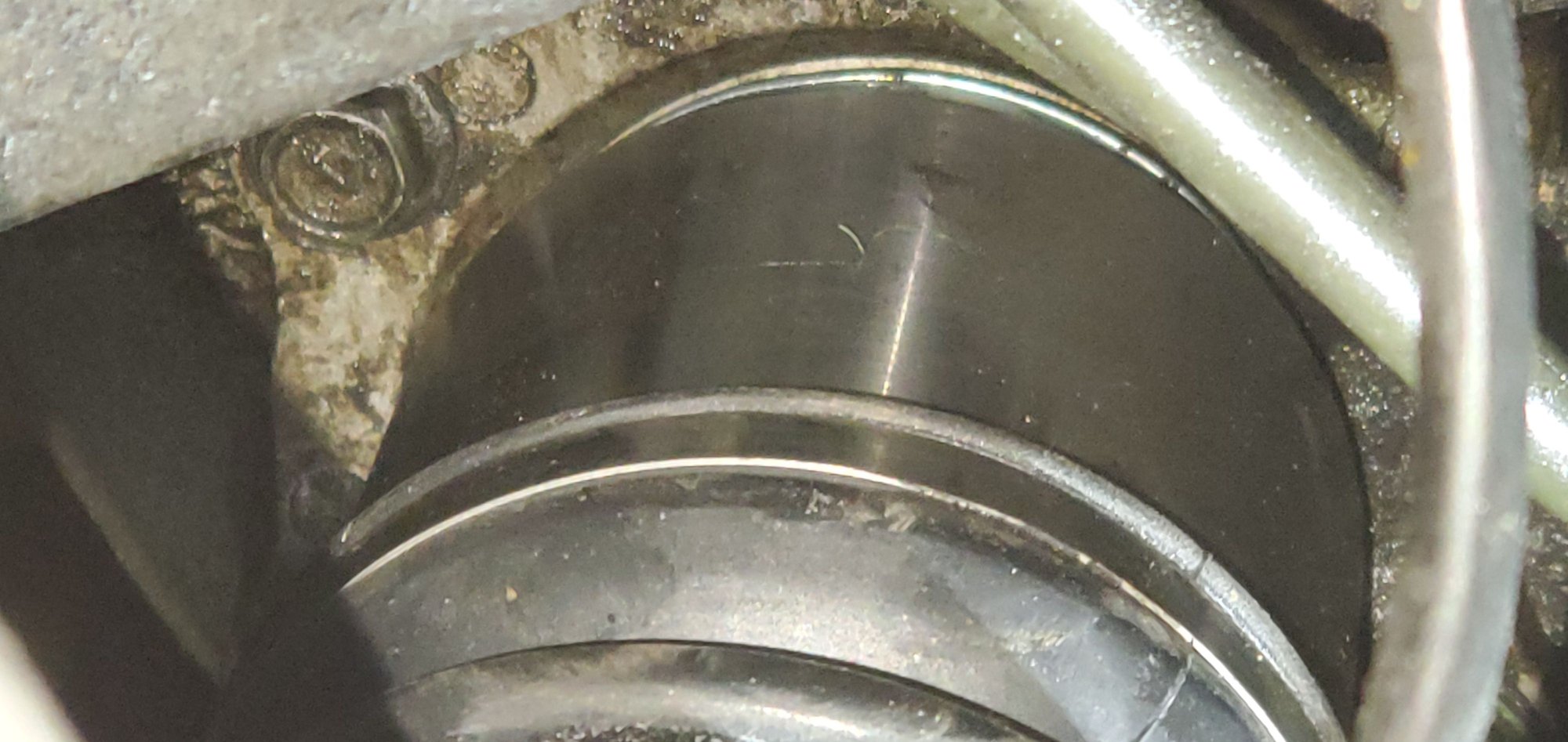

I have attached some pics

Is the axle nut tightened down? Also have you checked everything else for tightness? Was there a clicking noise? That usually indicates an axle issue in most cases

I used a cordless Milwaukee impact wrench to tighten it down

A cordless impact is not a torque wrench, axle nut torque is 92 ft/lbs.
