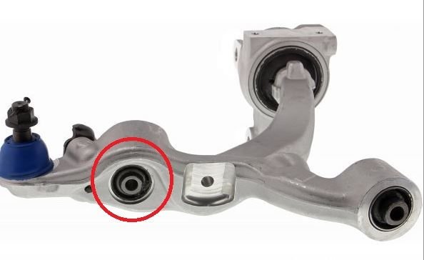

So, I had a thought yesterday while driving home, listening to the loud clunks I now have on both sides. After shaking the crap out of my tires I can generally assume the bushings and ball joints are all good (ball joints all look good on the outside). But then I thought about bushings that would tie into suspension travel, but not really into side to side movement, and came up with this. I'm thinking that my noise might actually be coming from the bushings where the yoke on the coilover attaches to the lower control arm.
It makes sense to me, up/down movement would make it move, turning would cause body roll which would put it under tension in 1 direction (effectively stopping any clunking), changing the coilovers would change the forces being exerted on it.
Anybody have any input to counter/correct my thought process?

Lift and support the front end so you can use a pry bar to see how much play you can get on that bushing. Also look for little cracks on the rubber between the inner/outer race, you will definitely need a flashlight on the bushing to help see, I also strongly recommend NOT wiping down the bushing initially, pry/look/pry/look, then wipe it down with a rag and pry/look again. You will need to use your best judgement where to line up the prybar to get pressure on that bushing from various angles.
I'm not a big fan of those factory rubber bushings, one of the best upgrades was the master poly bushing kit from energy suspension. It was pretty time consuming (strongly recommend doing the front first one weekend and the rear some other weekend) though, a 12ton press will be your friend, a couple of the bushings (subframe stuff) I just used a holesaw to hog out the rubber center section then a sawzall to cut the outer race (be careful it's easy to overcut) then a screwdriver to fold the race in on itself.
Be extremely liberal with your poly bushing grease so you don't end up with an accidental squeak. The 8oz tub of their own Energy Suspension grease was enough for the job.
I've heard a lot of good things about their stuff, only problem is that they don't have anything specific to the X, and that bushing is definitely specific to the X.
