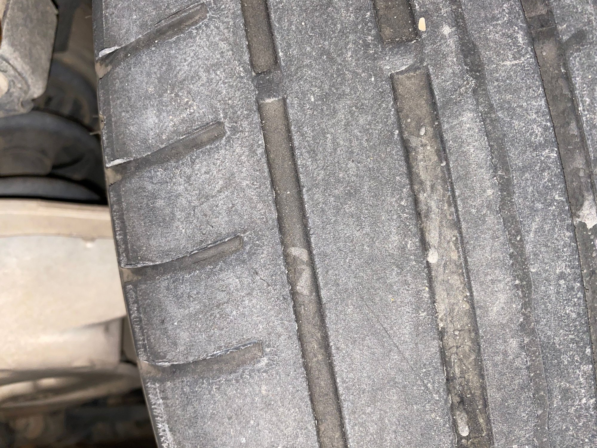

Getting both rears replaced. This is them with less than 7k miles on them. When they were put on a 4 wheel alignment was done right after. This is scary to me.

Looks like one of the wheels is bent too. This sucks. Problems of buying used I guess.

That was 100% definitely caused by someone doing smoky burnouts, I've seen literally hundreds of tires like that lol.
They ALMOST popped but you would be shocked just how long a tire in that condition can still last as long as you're not smoking them off again.

Thanks for the confirmation. I can't believe I missed this when looking over the car. Both rear shocks are covered in rubber debris from the burnouts too. Oh well. The only thing the tire guy was questioning was why the wear wasn't all across the tire leading him to think it was an alignment issue.
