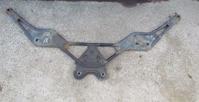

You're probably talking about this piece, it's a very common component to rust to pieces, buy another one for your car but before you install it clean it up good and paint it with an undercarriage paint. Needs to be something flexible like urethane or something else, bed liner would probably work good too.
It's the lower front subframe crossmember connector. The FSM calls it "front cross bar" but you won't get very good search results
What happens is the factory piece flexes quite a bit and the paint cracks in many places then the metal underneath rusts away to nothing.
eBay is a good way to source a replacement, or check your local pick-n-pull. Make sure you get one for a 2007-2008 sedan, I think they were the same on RWD and AWD but the 2003-2006 looks similar but will not fit.
