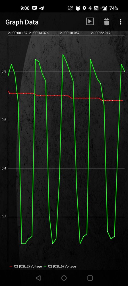

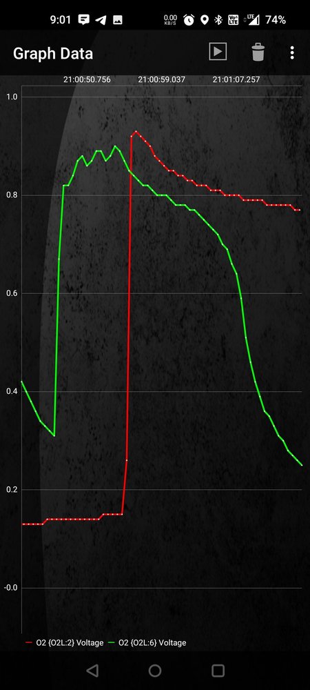

I do hear rattles from the driver side cat (confirmed by jacking the car up and giving it a listen), and it finally blessed me with a P0430 code. I erased the codes and will drive around for a few days to see if it pops back. My B2S2 is doing crazy stuff. Screen below (green is b2s2). I will switch rear O2s around and see if i get any different readings on the banks. Great video on cat efficiency (P0420/30):
My B2 appears to be doing exactly what the bad cat in this video is doing, tho he only speaks about "efficiency" and not exhaust restriction.

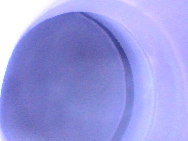

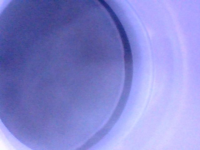

I also scoped the cat on that bank (pics below). The honeycomb is still there, but there is a visible gap on one side, as well as, what appears to be, some kind of shrapnel damge inside the exhaust pipe (looking down thru the o2 bung hole).

scope pics of the b2 cat. looks separated on the side(s).
shrapnel damage? looking directly thru the o2 hole

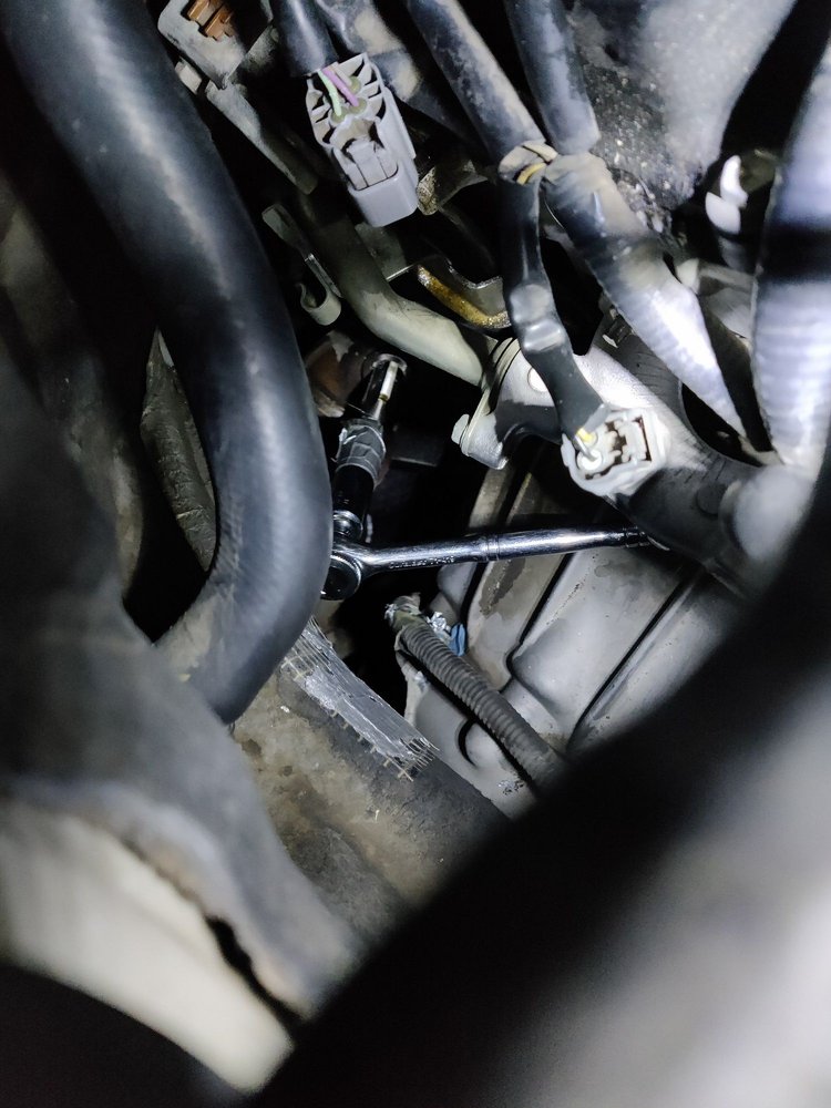

For the future the cats can sometimes be a breeze to remove, it depends a LOT on where you live.
The two forward facing bolts are reached pretty easily from the engine bay, you will need 36" worth of extensions and a swivel though, soak thoroughly in PB blaster, use only 6 point sockets. I typically break them by hand instead of using an impact since I still have not found a legit impact-rated 3/8 swivel that has the necessary amount of angle. 1/2" stuff won't fit, too tight on the driver side around the steering shaft.

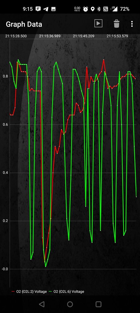

the driver side cat is def done for, it's just i'm not sure replacing it will fix this issue. When cold, both rear O2s read the same voltage, right around 0.4v, but when hot, the driver side one goes haywire.

I honestly think that most of the struggle with those bolts is not using that method. PB Blaster thoroughly, 6 point socket with swivel and FROM THE ENGINE BAY. Glad you got them off, make sure to check torque spec when reinstalling it's like 42 ft/lbs??
Also, be careful on the passenger side, STRONGLY recommend disconnecting the battery because if you drop an extension it can lay across the starter post.

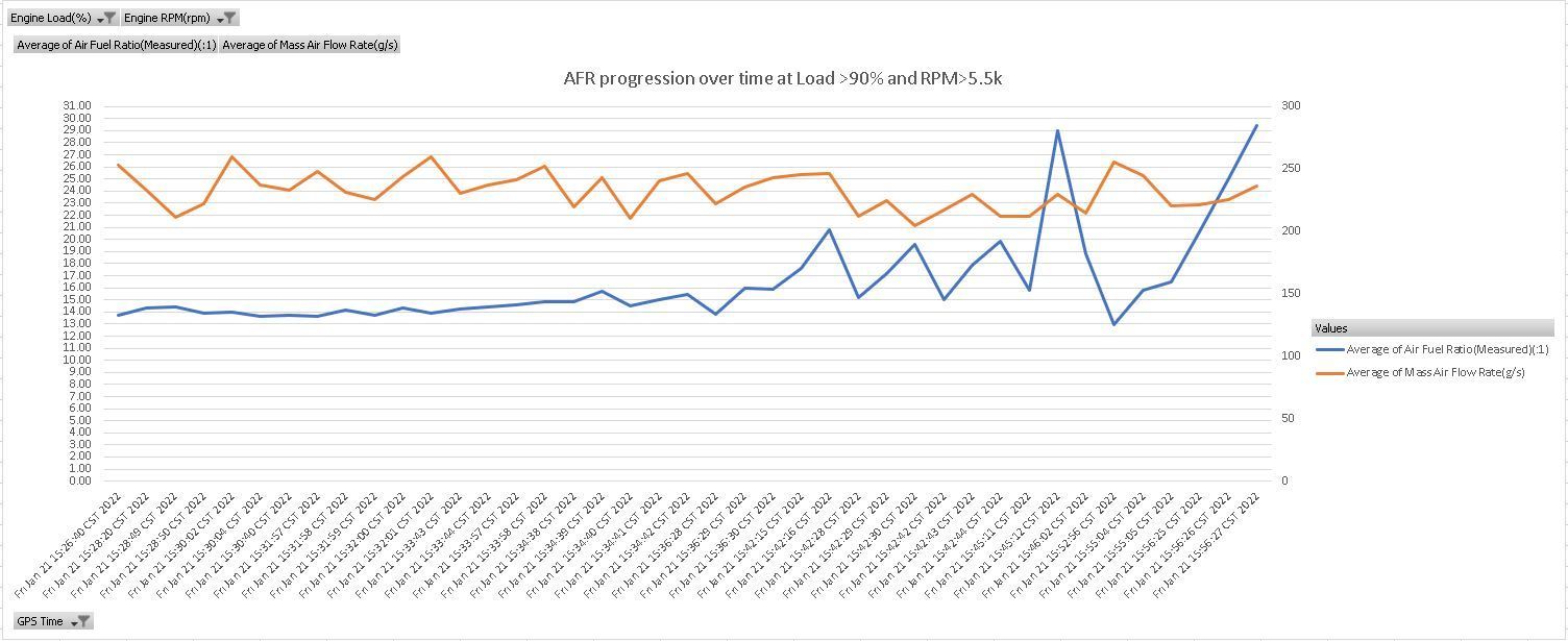

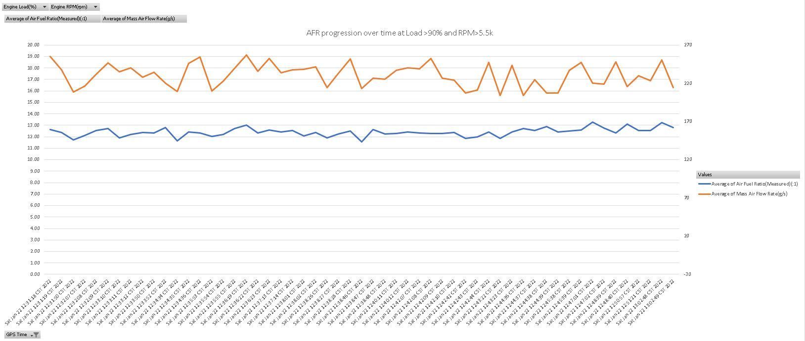

got the new pan on today and took her out. first rev to 7k+ in 1st she was almost losing traction in this cold weather lol drove beautifully for the first 15 mins or so. many wot pulls to the redline without an issue, but then the hesitation started returning. first tell-tale sign it was back, was that the rpm were not climbing nearly as fast as few minutes ago (1st gear test). i pulled off to the gas station and added more fuel, as it was getting near E. when restarting the car, it pulled strong once again (1st gear), but a few minutes later was falling on its face. i've done some data-logging and attaching some graphs below. you can see it's going leaner and leaner as the time progresses. both banks report lean, as measure by torque (wrong voltage, roughly 2x as high as what it should be - 2.2v or 14.7:1 afr at idle). at this point, it makes me think it's something fuel related. i wouldn't mind putting a new pump in her at this mileage, but hate the fact that i'm starting to throw parts it her. still no codes.

Here's what I would do, first thing is pull and inspect the plugs for some obviously different plug.
Next, do a pedal dance ECM reset, drive for a bit and see what long term fuel trim is doing.

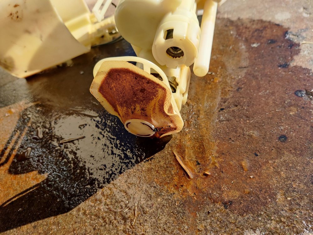

Install the VQ fuel port sandwich adapter so you can get accurate fuel pressure readings AND pull the fuel pump to see if the strainer baggy has a lot of sediment.
Smoke test intake AND exhaust for leaks. Clean MAF, verify PCV valve is rattling.
If still misbehaving, compression and leakdown to rule out a more major issue ...
And I would do them in that order. This is all assuming you can do the repairs yourself, if you are paying shop labor hourly rates go straight to Nissan for a 1hr diagnostic. Consult 3 is a huge timesaver, someday I hope to own a Consult diagnostic tool...

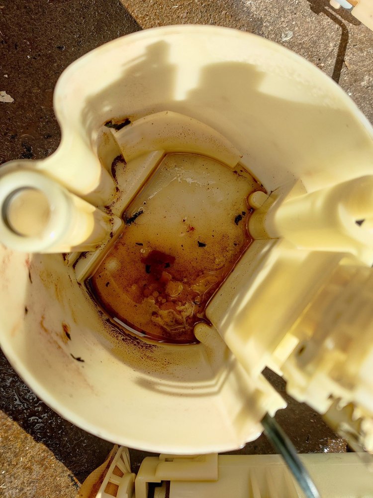

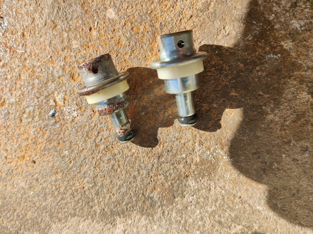

i was able to find an '07 sedan at a local lkq and pulled a pump out of it this morning. $30 - not too bad. i took mine off and here's what it looked like. never seen so much corrosion and rust on a pump before. the tank itself didn't look too bad - the gas didn't have any sediment. the bottom of the tank did have some specs of rust. i always run 100% gas in her, and my turbo rig is also on pump gas from the same station and doesn't have any rust problems, so this must've been occurring before my time. i went out and test drover her with multiple wot pulls and she is pulling strong. updated afr graph below. looks like 12.3-12.5 avg at wot now. i'm a bit skeptical of the "new" pump, since i have no clue how many miles it has on it. any recommendations for a good aftermarket pump? thanks again for sticking with me thru this, Cleric.
the funniest thing of this all is that my girl called it right away. she's as car illiterate as one gets, but she was sitting on the couch one night reading about this and blurted it out. i was like, "yeah, it'd be hilarious if you are correct" and whaddya know...
