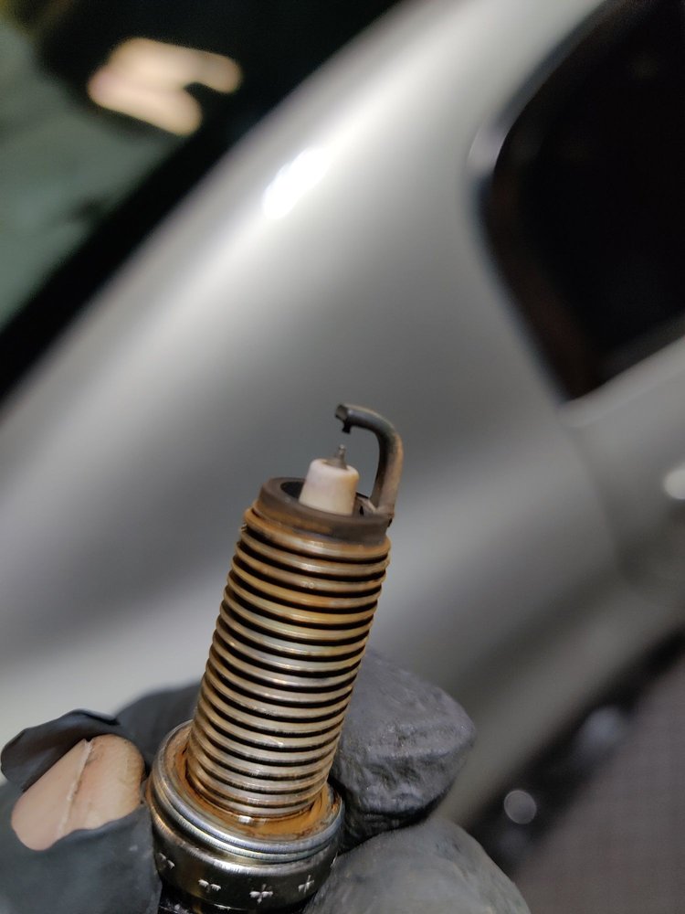

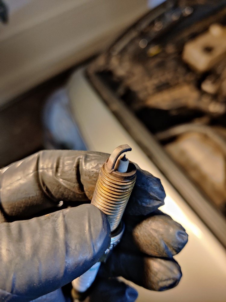

I went ahead and tore into it today. Checked plug and coil on #4 (pics below). Nothing looked out of order (gap was good), so I put it together and drove again. It set a #6 misfire code, so I went in and swapped the 1/3/5 coils over to 2/4/6. It then threw a #4 misfire again. It never sets the codes on the dash, but just indicates that it's missing (i can then read the codes via the apps). I'm attaching some screenshots from the diagnostic apps below as well. NDSIII shows bank 1 wideband reading a lot leaner than bank 2 under load. However, torque is showing bank 2 sensor 2 oscillating like a standard nb upstream o2, which would indicate an issue with the cat on that bank (or an excess of oxygen?).
I'm at a loss right now. Plugs look good and i doubt it's the coils, since i've swapped the banks. Checked around for vacuum leaks and couldn't find anything. Probably need to test the compression to rule out the mechanical stuff.

#4 plug
#4 plug
#6 plug
#6 plug

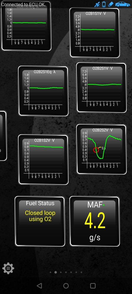

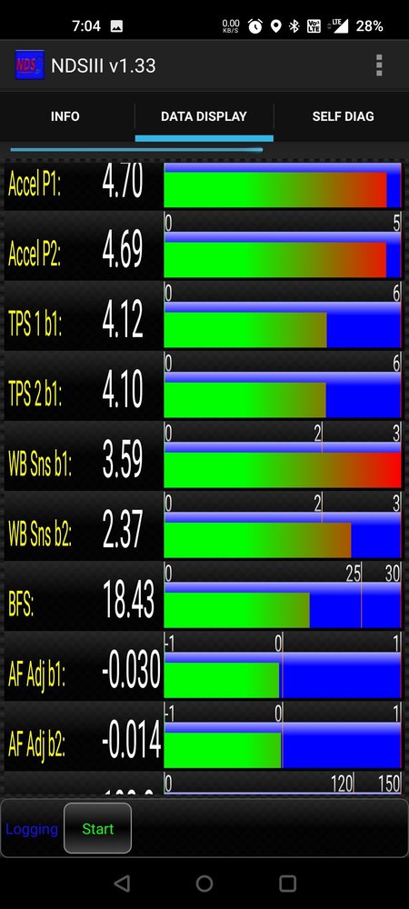

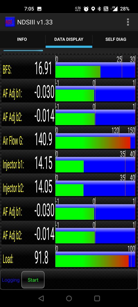

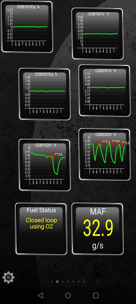

wideband bank1 goes a lot leaner than bank 2 under acceleration
Torque doesn't display correct voltage for the a/f sensors, but it looks like the rear o2 on bank 2 is oscillating while bank 1 is static. Does that indicate an issue with the cat?

In torque it's easier to go into graphing mode from the main screen, then pick the B1S1 and B2S1 O2 sensors, then just let it graph out (pretty the little play arrow button at the top) while you watch them both cycle up/down. I'm personally don't ever use that "realtime" mode that you are using. Always check O2 sensor cycling at idle.
It does look like something is up with bank 2 though, possibly the sensor or it might just be other cylinder conditions being so across the map that the ECM doesn't have time to make those minute fuel corrections that you will normally see the O2 sensor reading.
I would pull all of bank2 apart though, fully inspect the coil packs for blistering on the epoxy resin encapsulation top, scorching of the well tube boot, oil in the spark plug well tube, corrosion on the contact spring in the well tube boot, see if all 3 plugs look roughly the same with proper gap.
