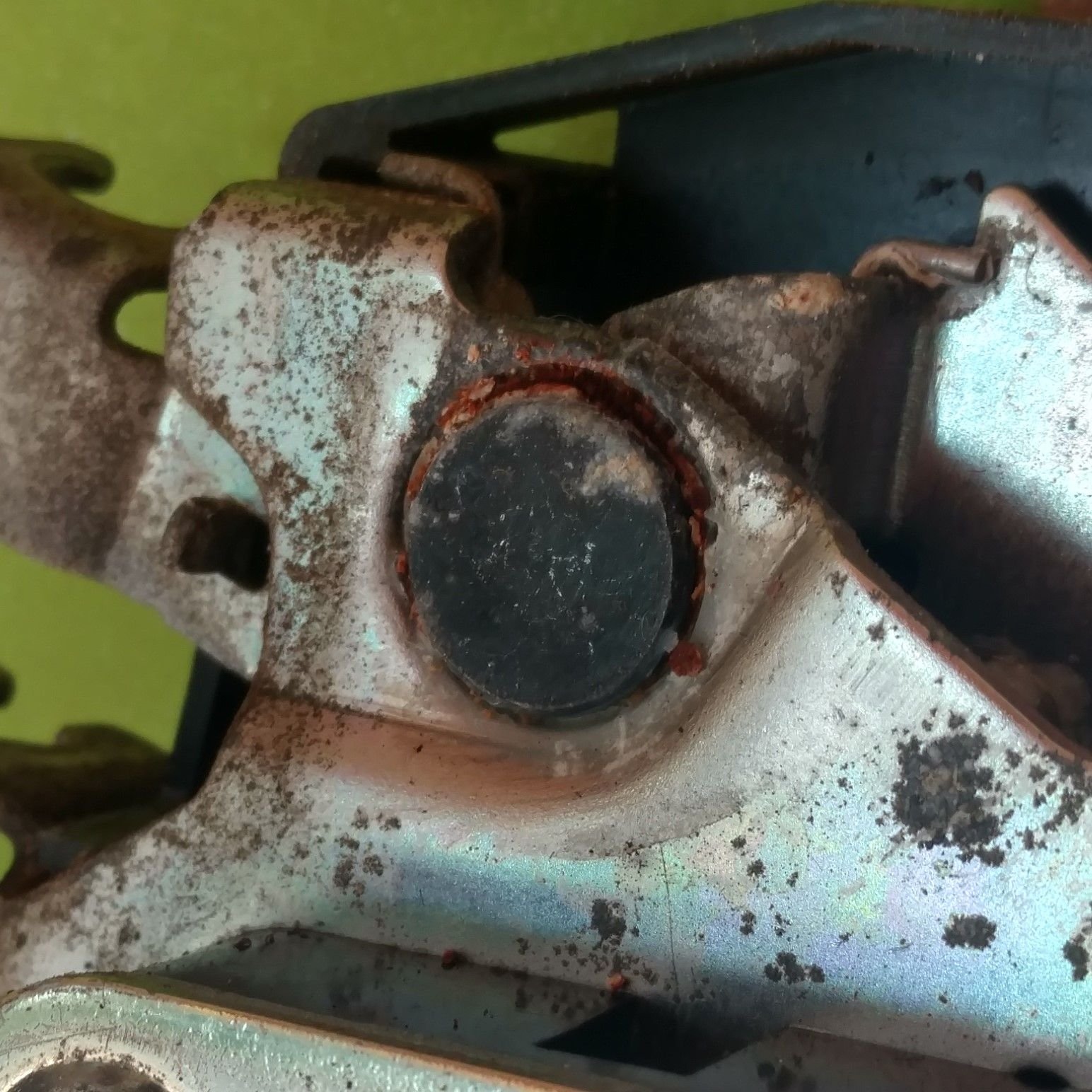

ACTUAL PROBLEM: In this case the problem was rust on the actuator main pivot pin and bell crank. The actuator has a spring that should return the bell crank a “lower” position. When you open the door and then release the door handle, the spring should return the bell crank the “lower” position. However, the rust (and possibly the age of the spring) overcame the normal return movement of the bell crank.

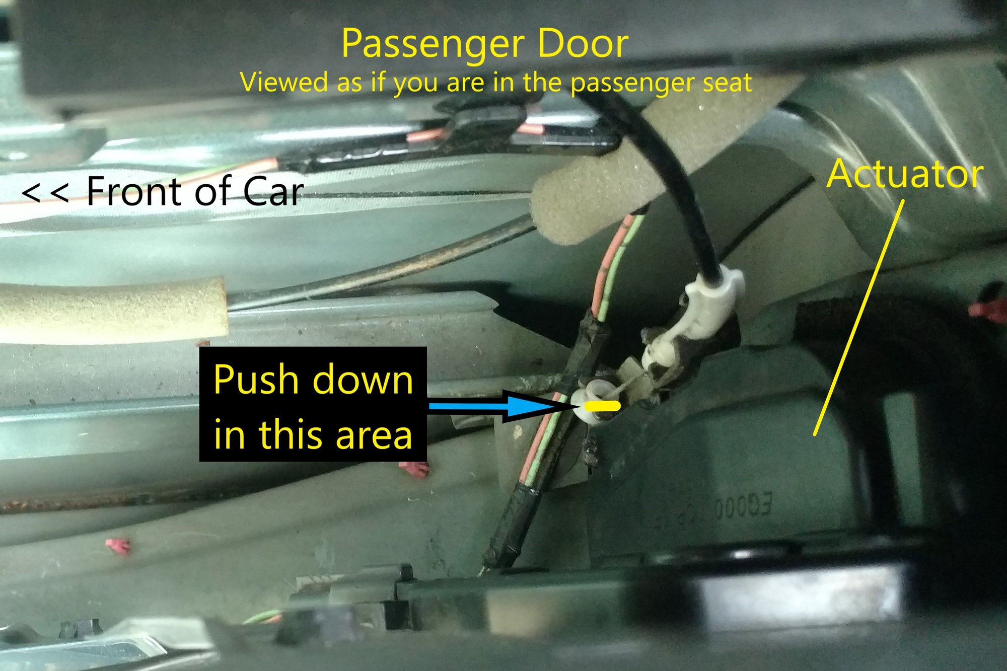

The first video showed that I could at least take a look-see into the door from the top and maybe release the door latch without damaging anything. The process worked, until I tried to understand what I was supposed to push down inside the door in order to release the latch. It’s just not clear in the video and I finally assumed that there might be a difference between the passenger side and the driver side door latching systems (there is, but it’s minor). In any case, with the help of a very bright LED light, I finally found something that responded and let the door open. The tool I used was a metal yardstick (it’s rather tight in there) instead of the socket extensions used in the video. This picture shows where I pushed down to release the door latch:
This picture was taken during reassembly and before the door glass was reinstalled. During the “latch release” process when the glass is still installed, the reflections from the glass may interfere seeing the “Push down” target clearly. All I can add is look for the wires and push down on the top of white nylon looking thing. Please remember, this is for a 2008 G35X, other years might be different.

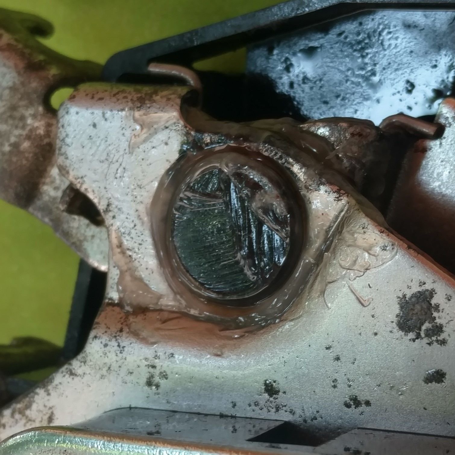

· Force a good grease into and around pin and spring area (I used GM Super Lube).

RUSTY PASSENGER ACTUATOR PIVOT PIN:
CLEANED UP w/GREASE:
