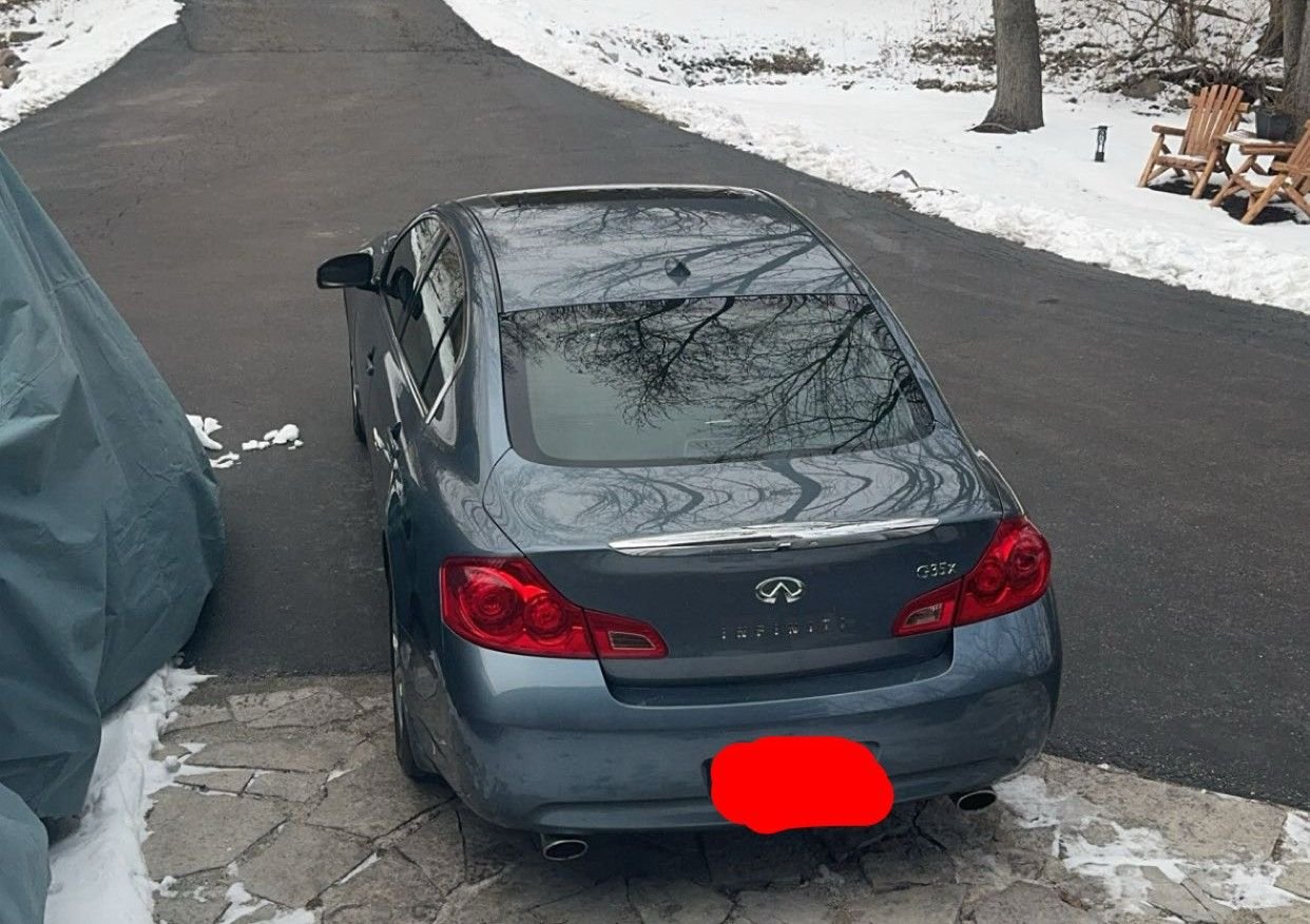

I recently purchased a 2008 automatic g35x with 115k miles on it very good condition other than a few rock chips from obvious highway driving, I was curious as this is my first Infinti coming from Audi and the horrible 2.0T, what is the recommended preventive maintenance? I plan on doing an oil change as soon as I get the time, I noticed occasional small transmission slips so I picked up some transmission fluid to do a simple drain and fill ~4-6 quartz. I wanted to possibly replace some suspension bushings; urethane is typically prone to going out after 10-15 years in my experience so I thought a refresh wouldn't hurt, what parts of the suspension are possible weak points as the year goes by? Is there anything I should know about the car or any pointers? I would really appreciate it thank you
P.S Im very anxious about cars after my paper weight of an Audi died 3 weeks after I got it.... I want this one to last me

my vpn didn't get the pics in the OP at first. that thing looks clean, man! debadge it and let 'er eat lol
