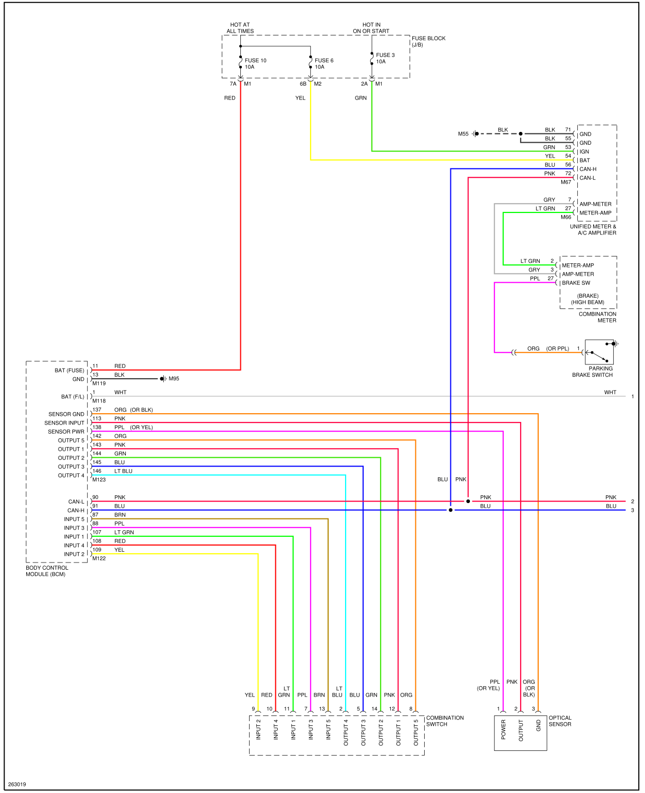

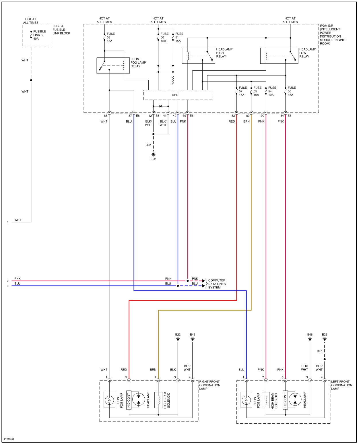

Here, headlight wiring diagram for a 07 G35 SEDAN V36:
2007 G35 Sedan V36 Headlight wiring diagram 01
2007 G35 Sedan V36 Headlight wiring diagram01
2007 G35 Sedan V36 Headlight wiring diagram 02
2007 G35 Sedan V36 Headlight wiring diagram02
As you can see, the IPDM controls them. When you switch Hi/Lo, do you hear a click sound from within the headlamp assembly? Those are Bi-Xenon headlamps and there is a 'eyelid' that goes up and down for the high beam effect. Relay is located inside the IPDM module and is not replaceable. If power goes into the IPDM from the lever switch but not to the headlamp, i would bypass the IPDM with a basic 4 pin relay to power up the eyelids.
