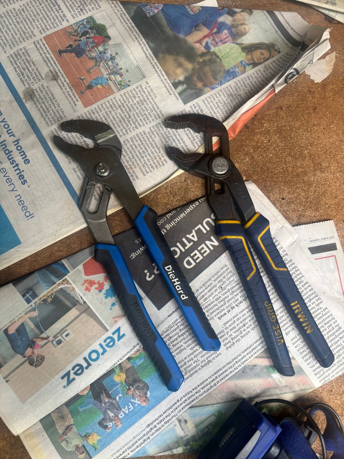

These are the most reliable wrenches i have

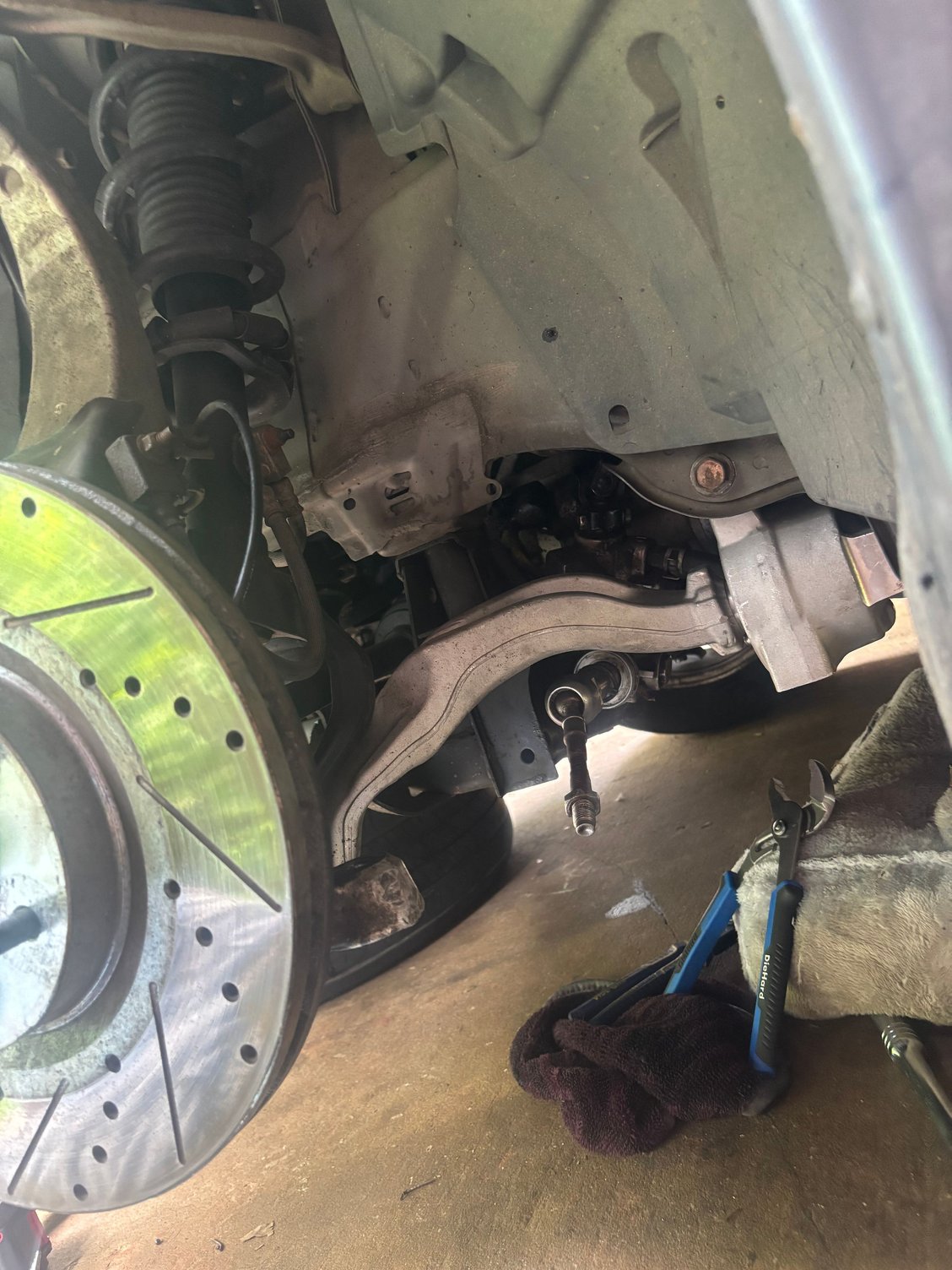

Cant get a tire rod tool to expensive i have pb blaster but no heat (the most is a lighter) i took off the locking pin and this thing is freakin hard to remove i mostly feel like if this was on a lift it would be way easier leverage any suggestions?

Yellow MAP gas torch, yellow is hotter than blue so get one, heat the head of the tie rod end for about a minute to melt the thread locker and it will unscrew with channel locks. Make sure to apply red thread locker to the new threads.
