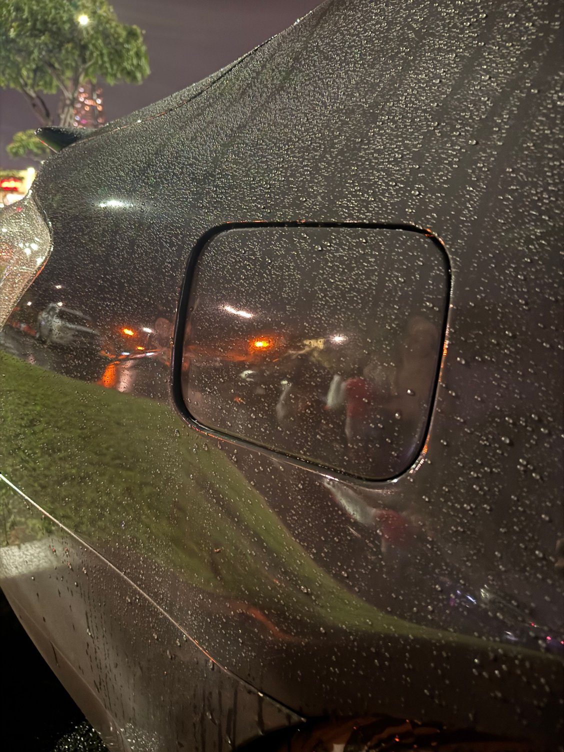

Anyone have any idea why my gas door is doing this? I’ve replaced the gas door too.

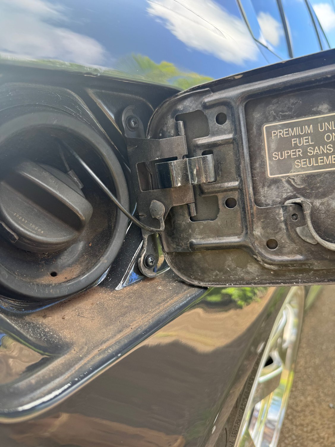

Is this the part you’re referring to?
Old Feb 23, 2026 | 04:50 PM
G2B35AGN's Avatar
Joined: Mar 2013
Posts: 2,004
Likes: 390
From: Raleigh, NC
Just checked my 2006 coupe. That looks different from what I have, but very similar. It's probably what you need.

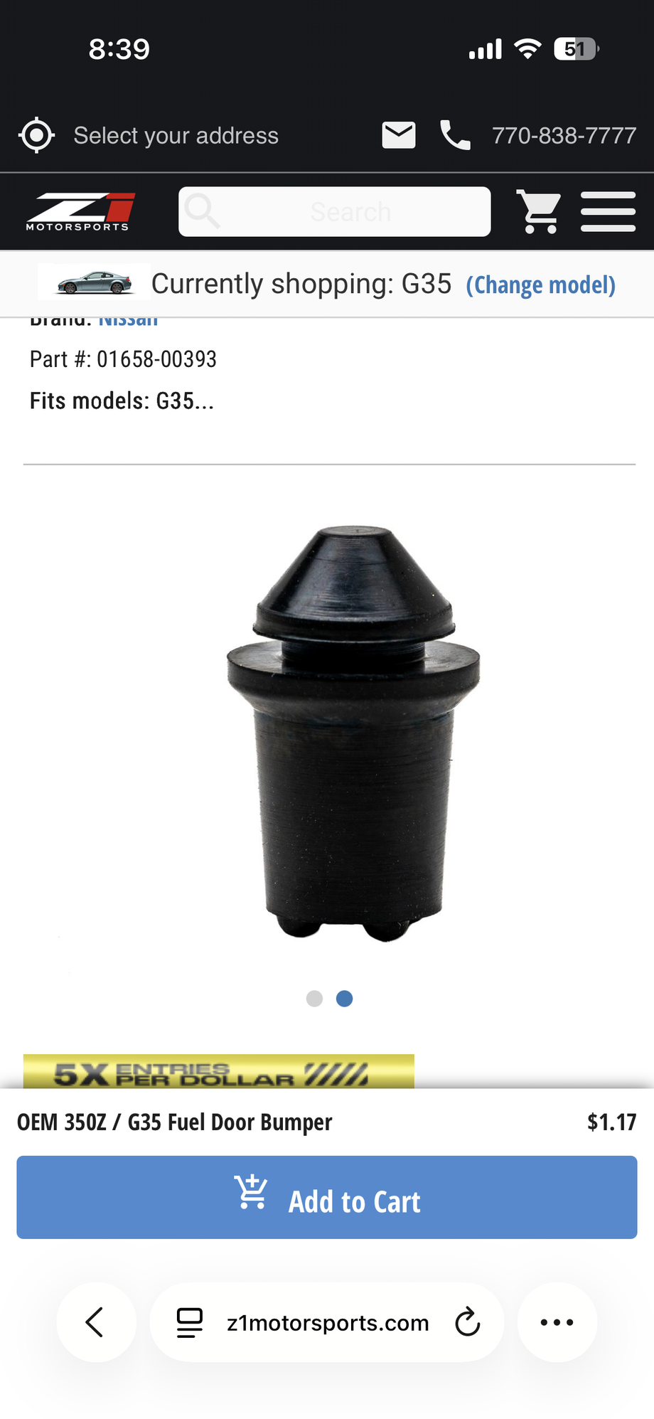

I believe this is the Nissan/Infiniti part number: 78837-EG00A
I’ll check it out, thank you.

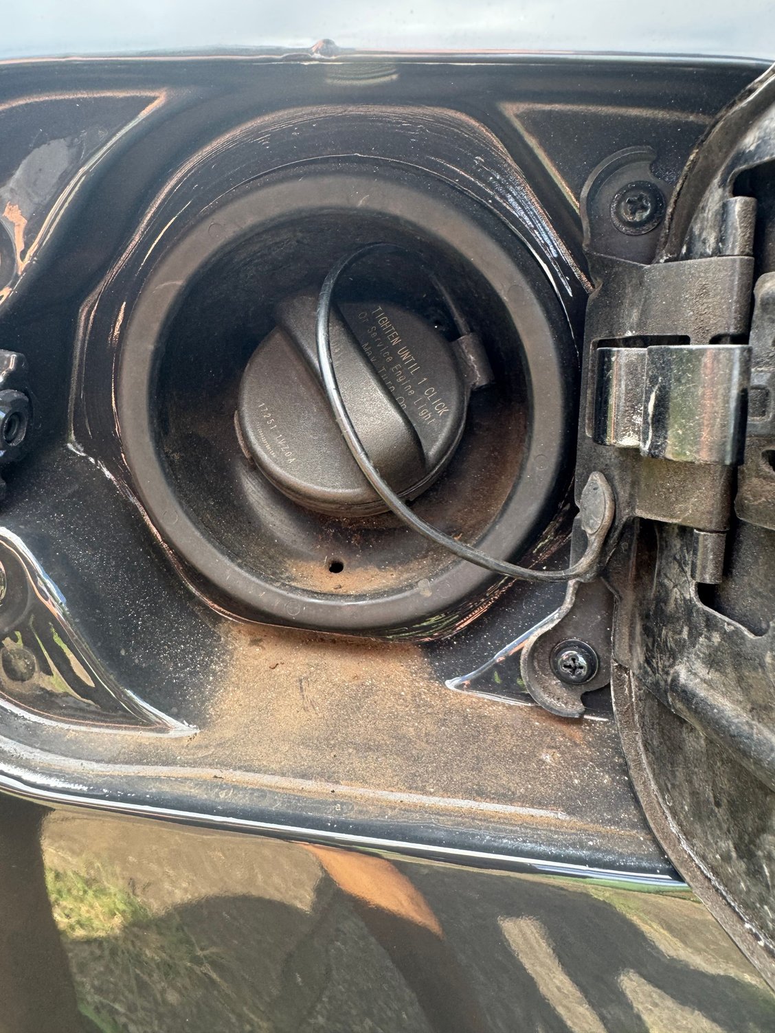

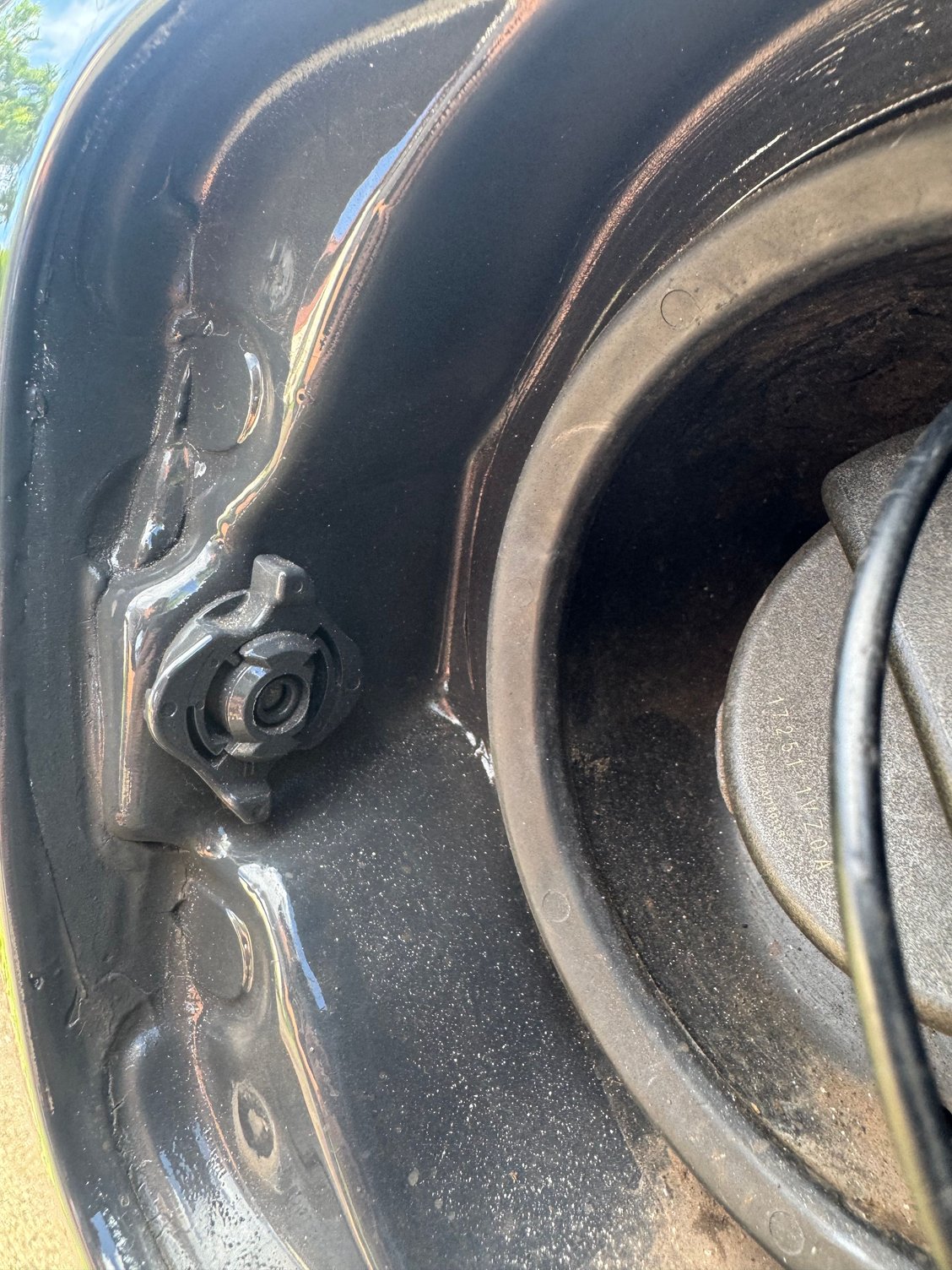

Here’s what my fuel door inside looks like. If it gives a better pov.
Old Feb 23, 2026 | 09:44 PM
G2B35AGN's Avatar
Joined: Mar 2013
Posts: 2,004
Likes: 390
From: Raleigh, NC
You don't show the outboard edge of the fuel door, but looking at the parts diagram, looks to me like you need two bumpers. They appear to attach to the non-hinge side of the fuel door in the top and bottom corners. There should be holes out there in the fuel door where they get stuck in.

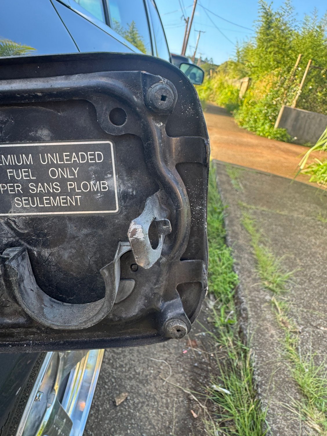

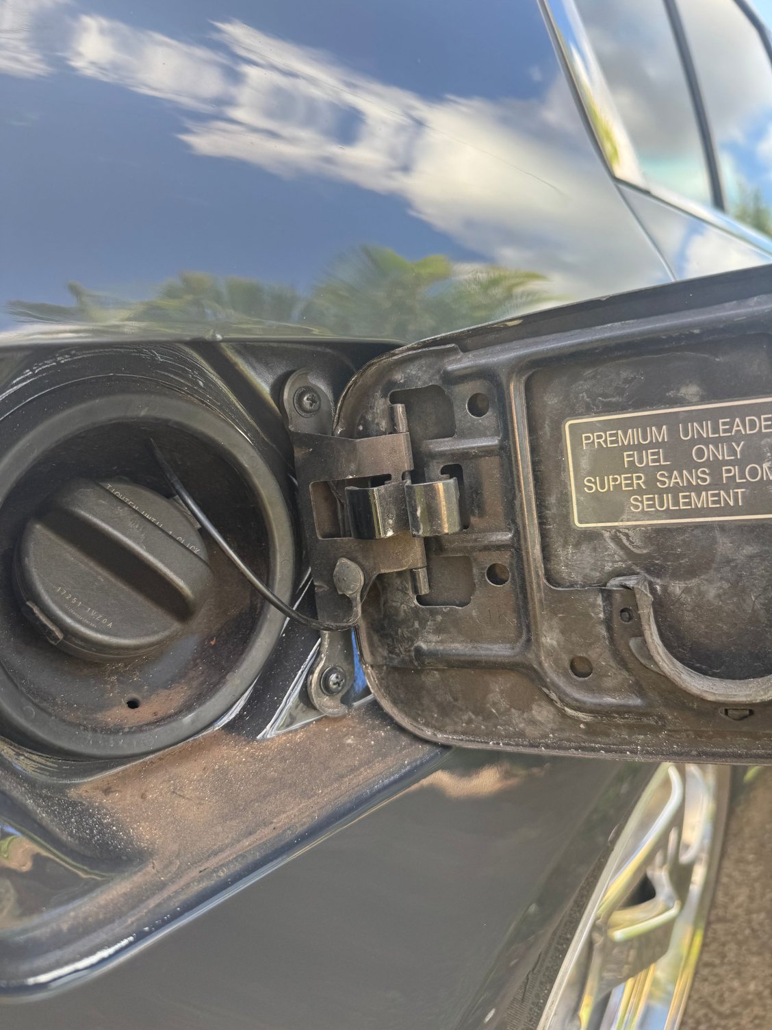

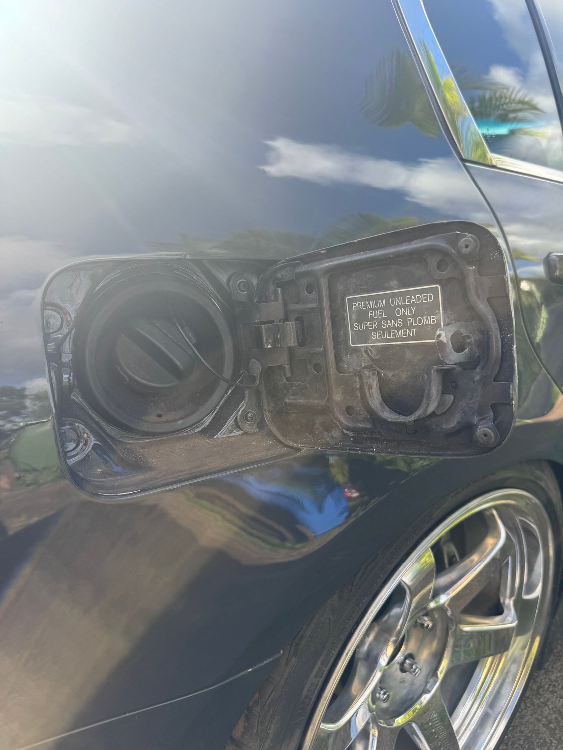

Is this a better picture? Sorry for the inconvenience
Old Feb 23, 2026 | 10:00 PM
G2B35AGN's Avatar
Joined: Mar 2013
Posts: 2,004
Likes: 390
From: Raleigh, NC
top picture of the last pair. See the two bumpers top and bottom outside corners of the frame holding the fuel door? They look worn out--smashed flat. I believe if you get two new bumpers and dig those old suckers out and push the pointy end of the new bumpers into the retainer holes, you'll be golden.

You’re talking about these correct?
Old Feb 23, 2026 | 10:18 PM
G2B35AGN's Avatar
Joined: Mar 2013
Posts: 2,004
Likes: 390
From: Raleigh, NC
Yep, them’s the ones….

Okay thank you! I’ll order them and update.
Old Feb 23, 2026 | 10:24 PM
G2B35AGN's Avatar
Joined: Mar 2013
Posts: 2,004
Likes: 390
From: Raleigh, NC
It’s also possible that the frame that holds them got bent when the door got pressed in too hard. You might first check to see if they are bent. If so, try to bend them back into position, but don’t lever on the fuel door; use needle nose pliers or similar to grab and bend. Don’t use a screwdriver against the fuel door.
