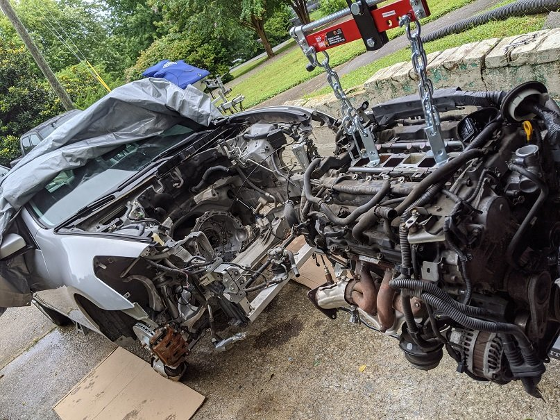

Why do I see this being my future?
EDIT: To be clear, not my pic!
Oh man... it has been a while. That is sorta hot, but ... eh... raunchy too. You know you are committed once you get that far. No turning back :-)

I know that isn't your picture but in case anyone else comes across it I really don't recommend pulling the engine by the manifold to plenum bolts like that, those are some pretty small fasteners. On the front of the engine in the very middle are these two very large bolts that are used for the motor mounts when the engine is mounted transversely (Maxima, Altima). You can remove them and bolt on tabs to attach a sling or chain. To support the rear of the engine I prefer to sling the header at cylinder 5 and 6 unless you're pulling the engine/tranny assembled in which case you remove the top two engine/tranny bellhousing bolts and bolts tabs onto that location.
For slings I absolutely recommend Herculine 2500 mule tape. It's rated 2500 lbs, it's very thin and easy to work with, holds a knot well, you can adjust for rotational play by merely untying the knot and readjusting it.
There's a lot of other options for the Herculine, just look up "pull tape flat rope mule tape". It's normally used for electrical to pull big wire into conduit.
Amazon Amazon
Mule tape won't scratch up components like a chain will.
