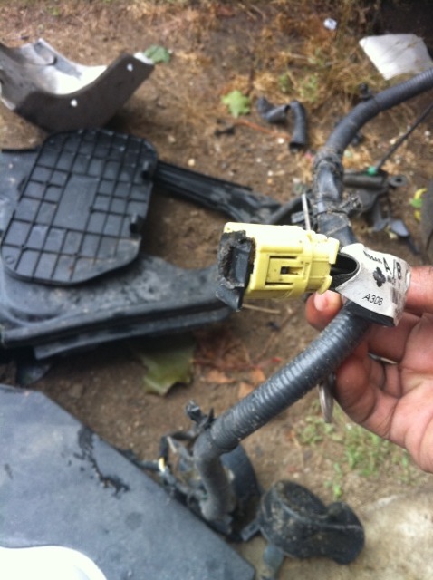

i have a 2005 g35 coupe i need know to what part this plugs into is it maybe a crash sensor

the wires are orange and white i think cant remember right now because im not close to the car

Well, the crash zone sensor that lives right behind the grill has orange and white wires and that looks a "don't unplug this" type of connector. I won't ask why the pile of parts and you're not near the car...

if it's yellow, most likely it has to do with the airbag system.

Yeah, yellow plug, crash zone sensor, SRS system. I think it's this:
http://www.InfinitiPartsUSA.com/part...layCatalogid=0
Looks like there's a bracket for it too.
Based on your pic, the pile of front end parts, and the fact you might need a new crash sensor, I'm wondering if you hit a tree? None of my business but hope all is well. Are you sure the sensor is ruined?

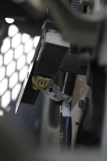

Here's what it looks like in an '06 sedan - right behind the grill, right in front of the radiator. There's your yellow connector.
Attached Thumbnails Can someone tell me what parts are missing-sensor.jpg   Can someone tell me what parts are missing-sensor2.jpg
