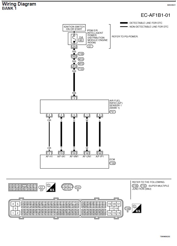

anyone know if there are any o2 heater fuses?

Yes #85 a 15Amp, behind the battery

so after messing with the g for about the past hour i found the suprise fuse box behind the batt and checked the fuse that said o2 (not sure if this is #85 or not) but its not blown..
im really starting to hate this car...
hangup n' drive can you varify if this is fuse #85? ive searched up and down but cant find any fuse box diagrams on driver or google
thanks for the help!

Both banks run on the same fuse.
Attached Thumbnails o2 heater problems please help-ipdm.jpg   o2 heater problems please help-o2wiring.jpg

thanks im gonna take a look again and make sure it was the right one
