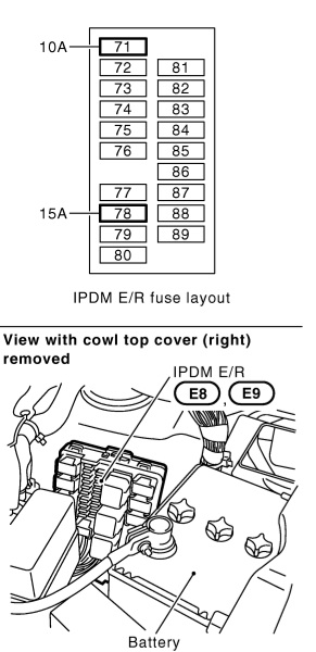

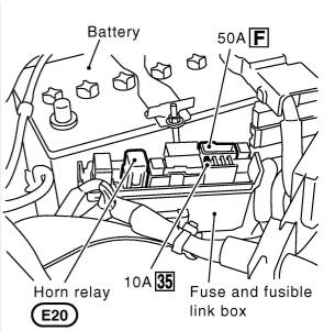

Do you mean you think the keyless entry computer in your car has failed? There are several fuses to check before you spend the dough on the black box...
In the passenger compartment, the fusebox by the driver's footrest - check #1, #6, #18 and #21.
If those are good head under the hood in the "fusable links" box in front of the battery (see first pic below) check that 10A fuse and the 50A fuse (although if the 50A were blown I don't think anything would work).
If those are good there are a few more in the box to the left of the battery (see 2nd pic) as indicated #71 and #78.
good luck!
