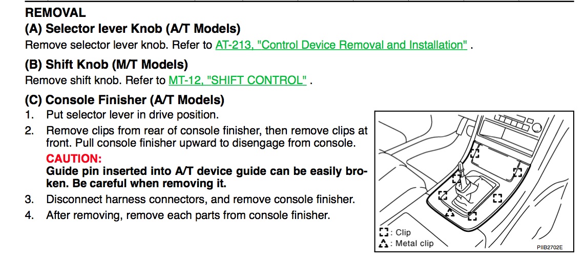

Here is the drawing of the original **** and retaining clip and how the center console piece is held in place in case you want to pull the boot off for a look. By the way your service manuals are here:
http://psedog.com/cars/fsm/g35/coupe/2007/
There is a linkage adjustment down below - from the bottom of the lever to the tranny - but it would seem unlikely that your issue would involve that. I am NO mechanic, others here would know better.
Attached Thumbnails Weird Parking Problem-knob.jpg   Weird Parking Problem-consolepart.jpg
