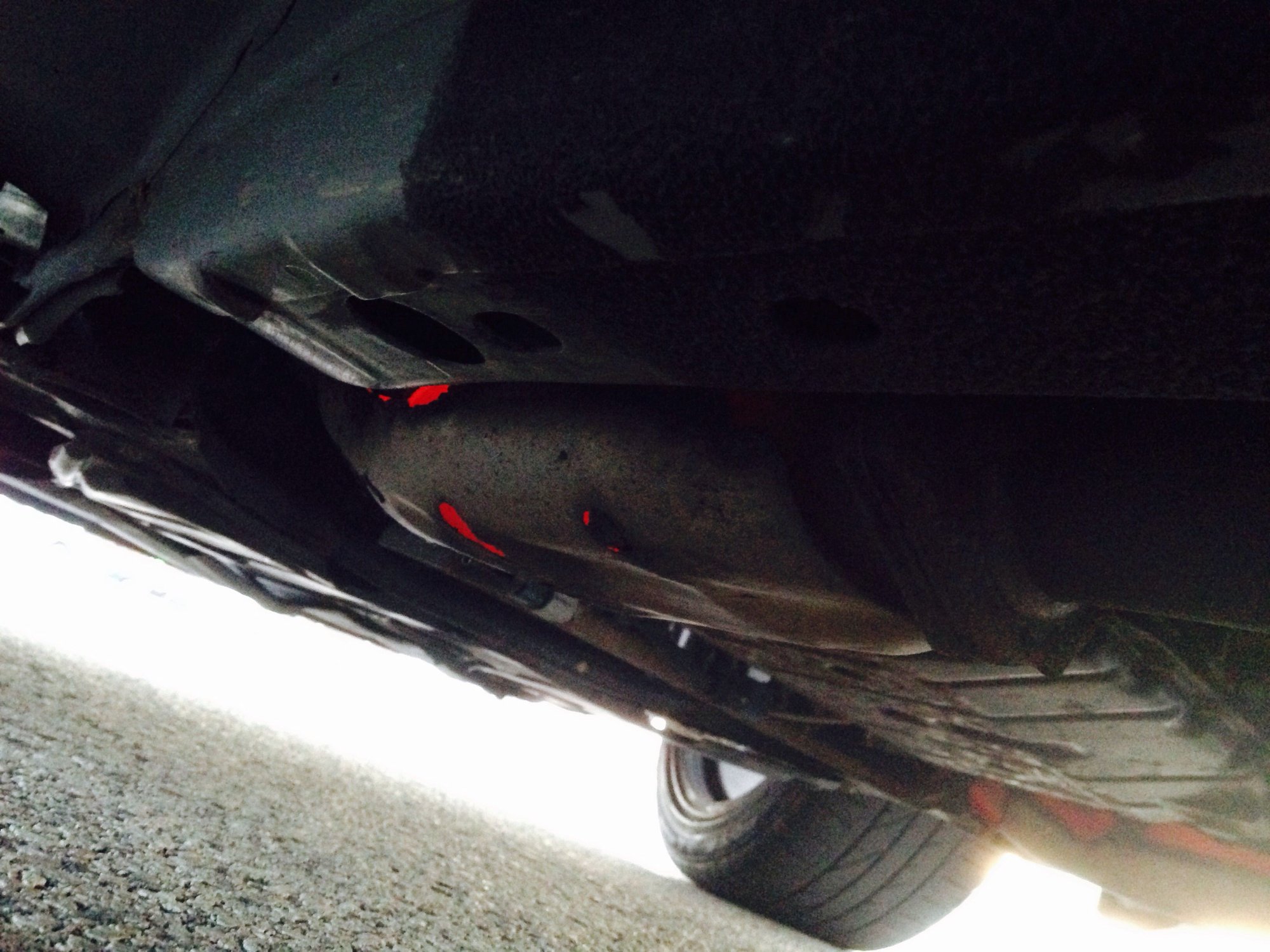

Today, I was heading to a car meet, turned Vdc off on the way and had a little fun .. I pulled over for a moment to take a call after, i put my car in drive and it turned off right away ... I tried starting it over and over, It would crank and turn on but die quickly like there was no gas... Temperatures were fine .. Oil was just changed and full tank of gas .. Popped the hood everything seemed fine .. Then checked under the car and seen " vapor/smoke" coming from my driver side cat .. When I got a closer look there where parts of it that were completely red and possibly melting soon and it looked like my car was going to catch on fire .
I assume the cats are clogged ? My g35 coupe is Completely stock, no dash indicators or anything.
I Sat for a few mins then car turned on fine and I went about my day . I need to fix this before something happens worse than that ...I think it's running a few degrees hotter, I can tell there is some power loss because when I punch it , it doesn't go like it a did a few days ago .. Is it really a clogged cat or is it something else ?
Suggestions please ?!!!

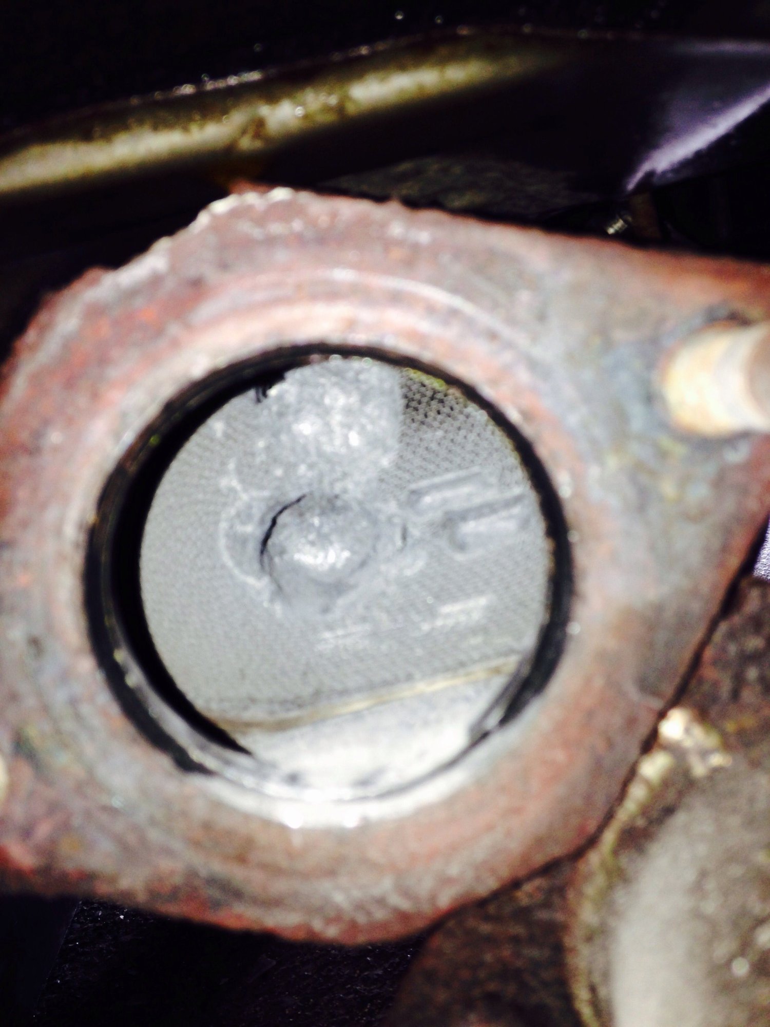

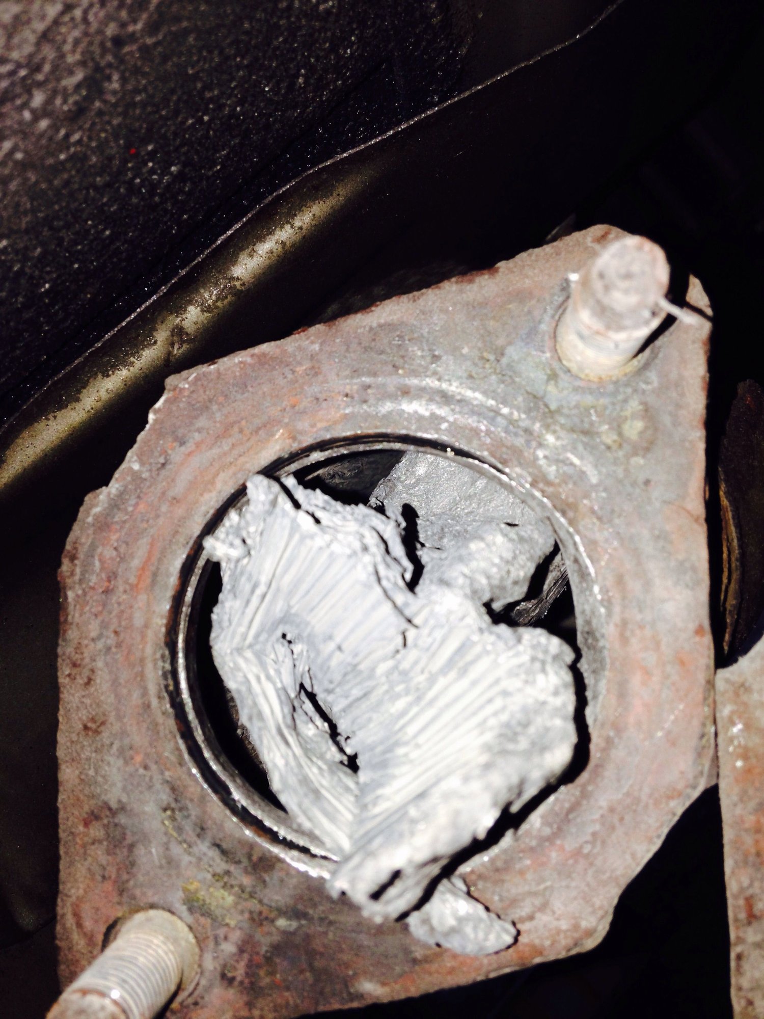

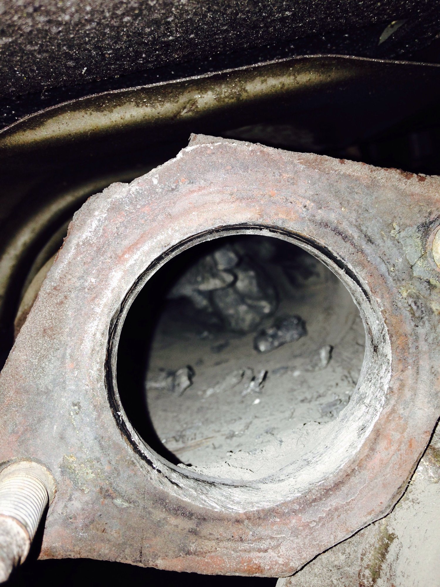

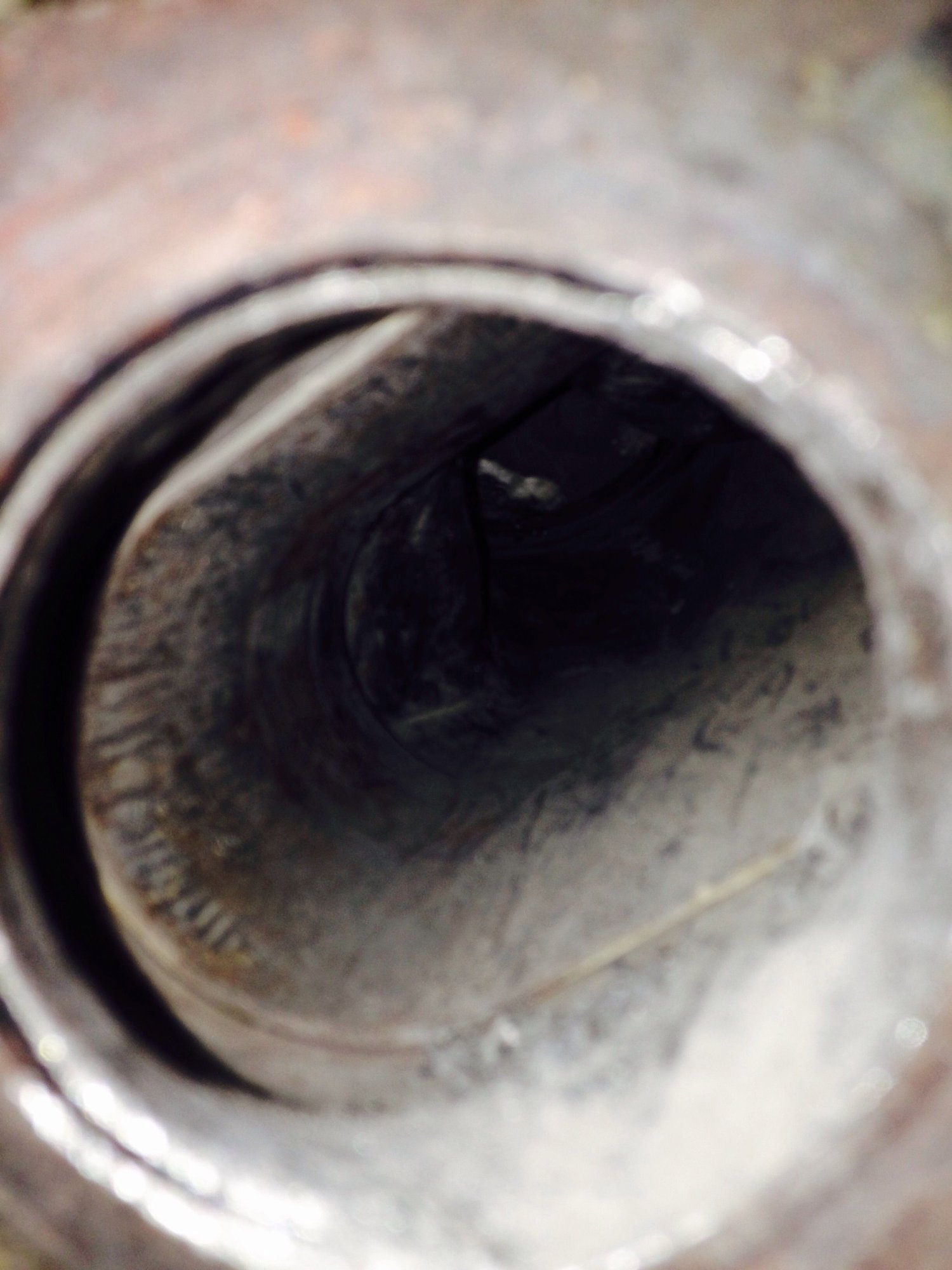

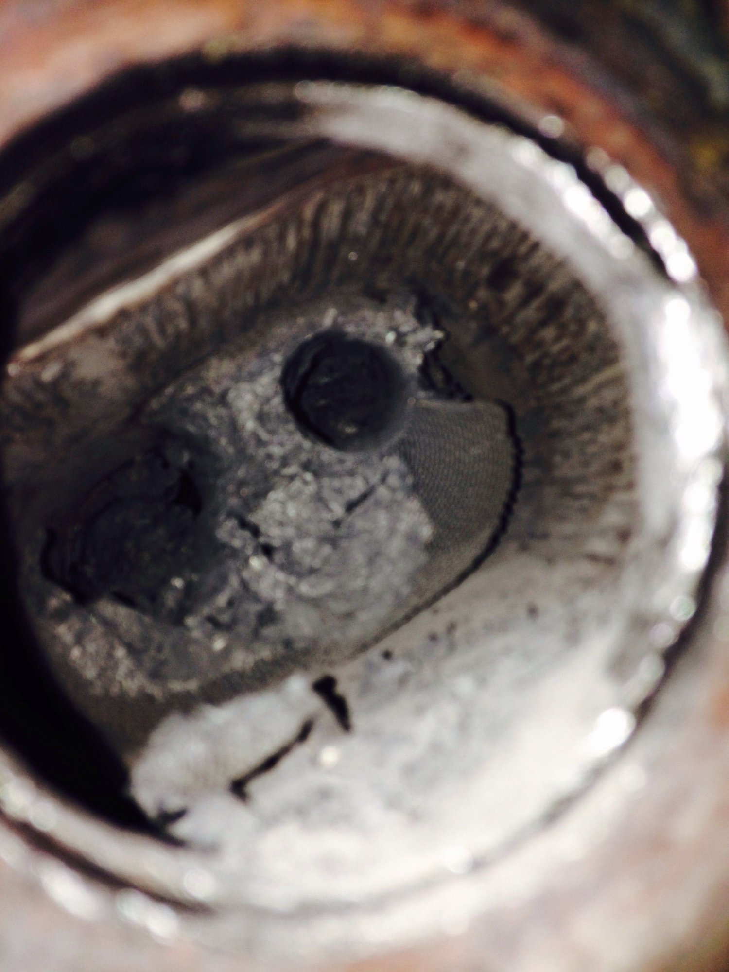

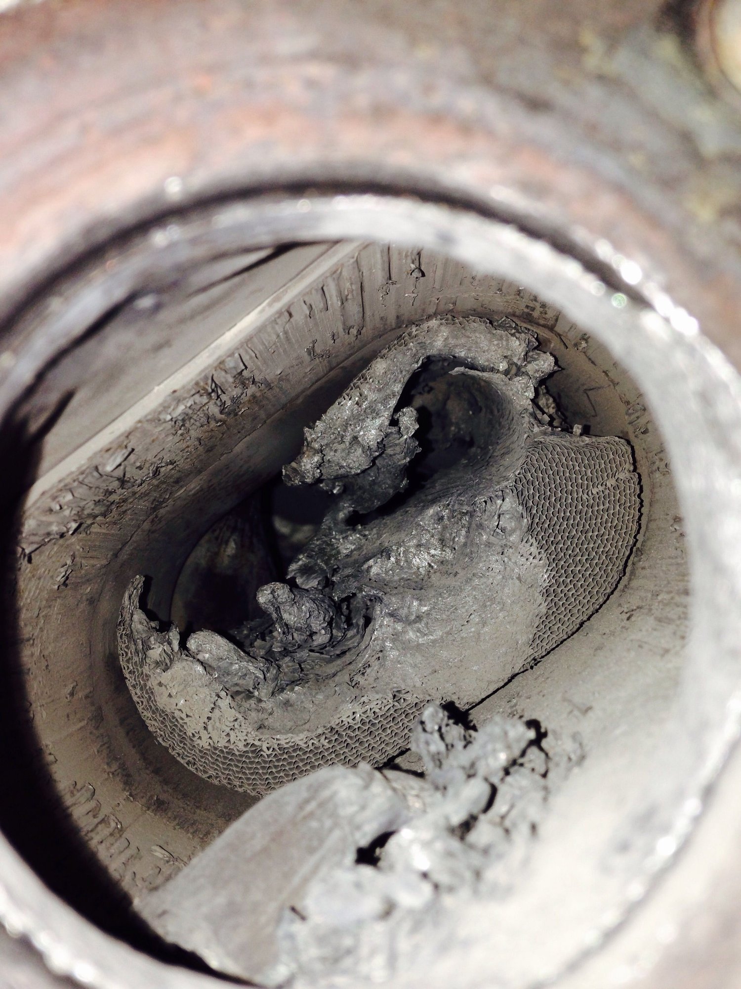

So I went with gutting it since it was the only thing I could do atm and it was free .. It was impossible to " simply take a screw driver and poke it out " if anyone plans of gutting I do not recommend using a hammer , crowbar, or screw driver to get the insides out although those are all things I used.... along with a heavy duty hammer drill. It is not a simple process and will take hrs .. Took me 5hrs to get it out. 2 hrs in I started drilling . Here are some progress pictures
Tried crowbar, pipes , screw drivers hammers and that's all that was done especially hard if you don't have a lift .. I used ramps
Started drilling with the Bausch hammer drill
Lots of dust .. Always be safe .. Some eye wear would of helped save a few minutes too haha
I was drilling and it pushed it back into the cart .. So be careful of this .. I eventually got it back to wear I was able to pinch so that I can drill it again
Final small block was a pain to drill and get out
Gutted and clear 😍

Just replace with hi-flow cats. Also, your right side is glowing also and is probably clogged.
It looks like you only removed about half of the cat material. There's more in front of the O2 sensor after the bend. The system basically goes <header - O2 #1>|<cat material - O2 #2 - cat material>|<y-pipe> Hope you removed the O2 sensor while you were drilling and hammering away to avoid damage.
Here's a pic of the whole thing to give you an idea of how much material may still be in there:
