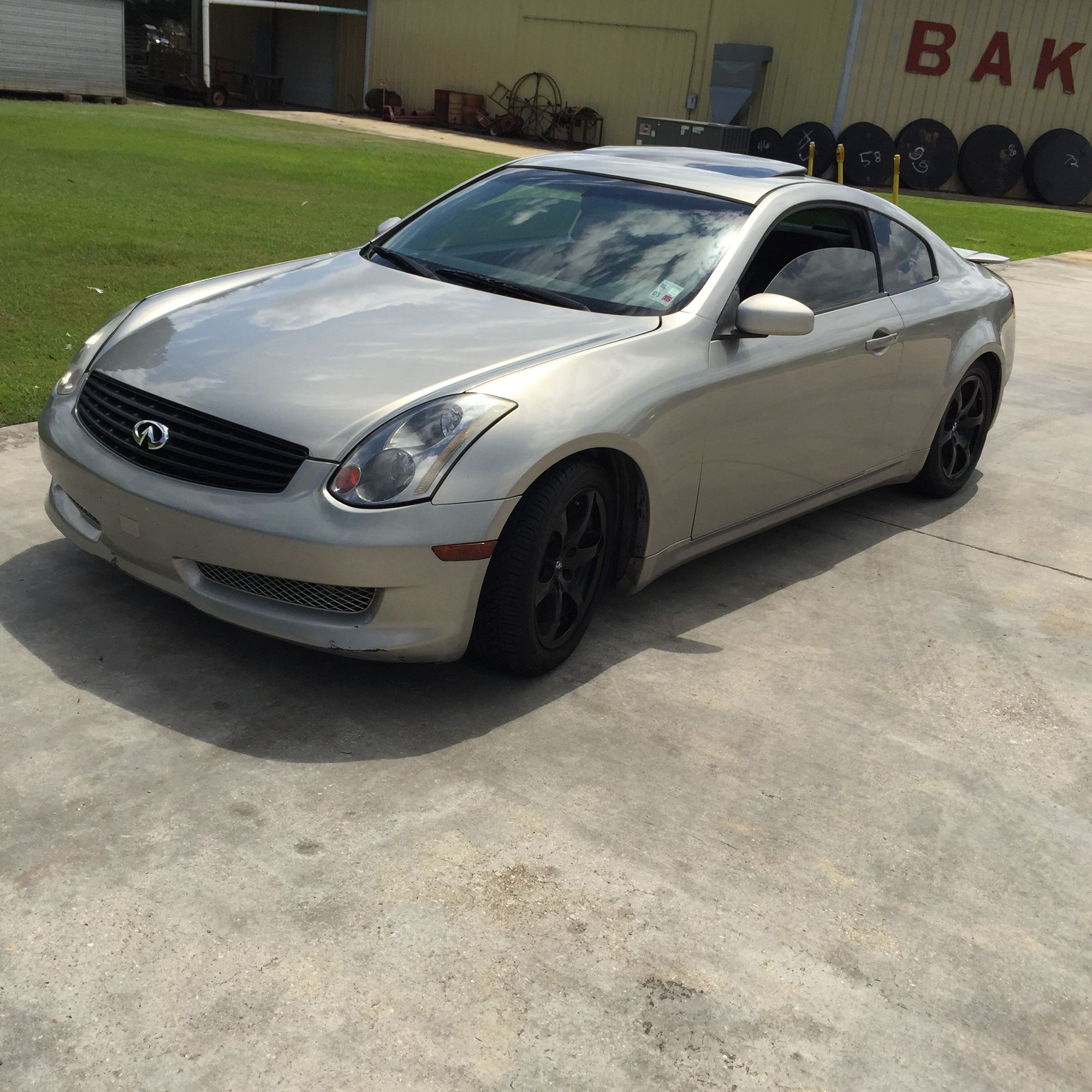

Tune Up Time
My car has finally reached 160,000mi.
I want to thank my G with a nice good tune up.
Any suggestions or advice on where I should start?
2003 G35 Coupe 5at
