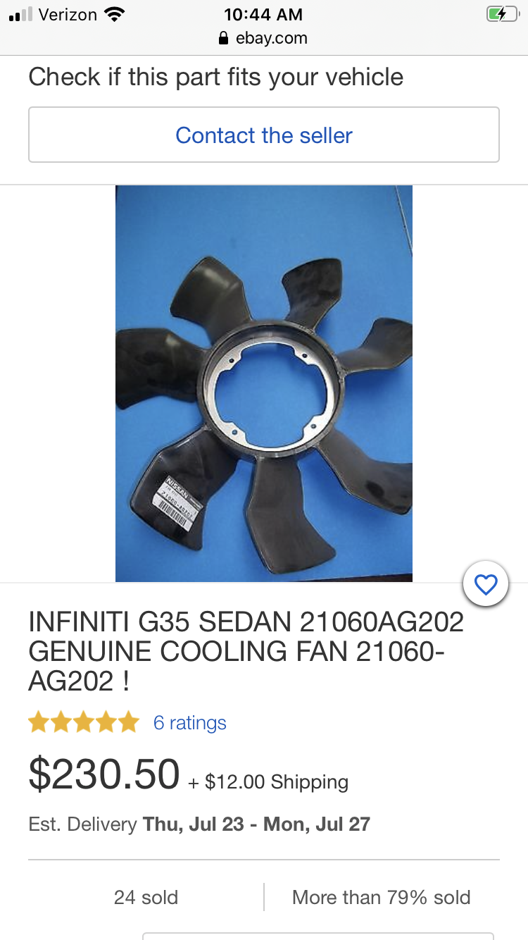

Old Jul 21, 2020 | 06:13 PM
DRIFTLY's Avatar
Joined: May 2019
Posts: 8
2003 G35 Sedan aka - “DRIFTLY”
You’re forgetting something.
I have a 2003 Auto Sedan non sport models.
these cars came with: “CLUTCH FANS!”
Not the dual electric fan set up like the “Sport models did, ie the manual/Brembo cars.
ive been trying to find stock replacements and have bad luck in the states.
they only made these car setups for 8 months then decided to just go with all the cars having dual electric fans 04 and beyond no matter the trim model of the car.
so these parts are so rare in the states that a company was going to charge me $230 for the “Fan Blade”!!! That’s not including the clutch!!! I don’t need the clutch regardless. But wow.
I ended up ordering overseas from Dubai, part was like $53 (JDM Genuine Nissan part) and then $40 for shipping and will be here tomorrow. I ordered it on Sunday and it’ll be here tomorrow!!
now just need to hunt down a fan shroud.
hope this help guys!!
-DRIFTLY
